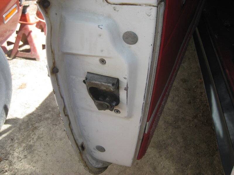

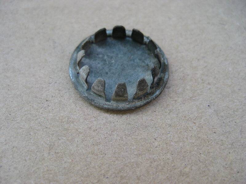

#1 The each door has two metal plugs in them. I'm just wondering if what I have is the correct plugs, or did someone replace them at some point. (see photo)

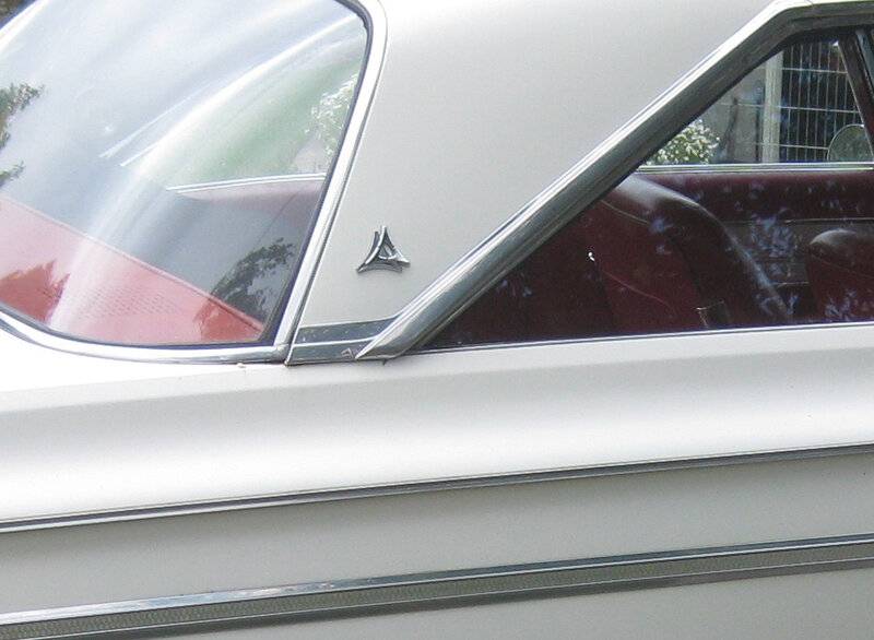

#2 The Dodge emblem on the roof panel (see photo). Are there emblem nuts holding it on? Or, is it held on by the push in, tension fit type retainers? I really don't want to pull the headliner up to get this emblem off.

Yes those are the correct factory cap plugs! And the medallions are held on with a nut, You'll have to pull the headliner loose.
I'm curious to know the purpose of the door plugs? ( I have a 64 Polara convertible). Is there a part of the window regulator or door glass that is adjusted behind those plugs? My doors are off my car but I'll have to look later today to see if mine has the same holes in the same exact locations.
As a teenager in the late 70's I worked part time at a Chevy dealership while finishing high school. When a customer wanted a new vehicle to be undercoated, the dealership would spray the underside of the car or truck. They'd also drill a hole in each door in the same area as Detroit Iron's photo so that a long, thin wand could be inserted and undercoating sprayed inside the door. A plastic plug was then put into the hole.

I keep telling myself I'm not going to disassemble the entire car.... but one thing leads to another and... I have to disassemble the entire car. Haha.. Thanks for the input. That really helps. Here goes.... gotta do it right. The headliner is original, so I assume once I disturb the corner, the rest will go to hell in short time. Headliner should really be replaced anyway.

Behind the plugs are........ NOTHING! Behind the top plug is the door lock rod, and I don't see anything behind the lower plug. They must be for something in the manufacturing process.

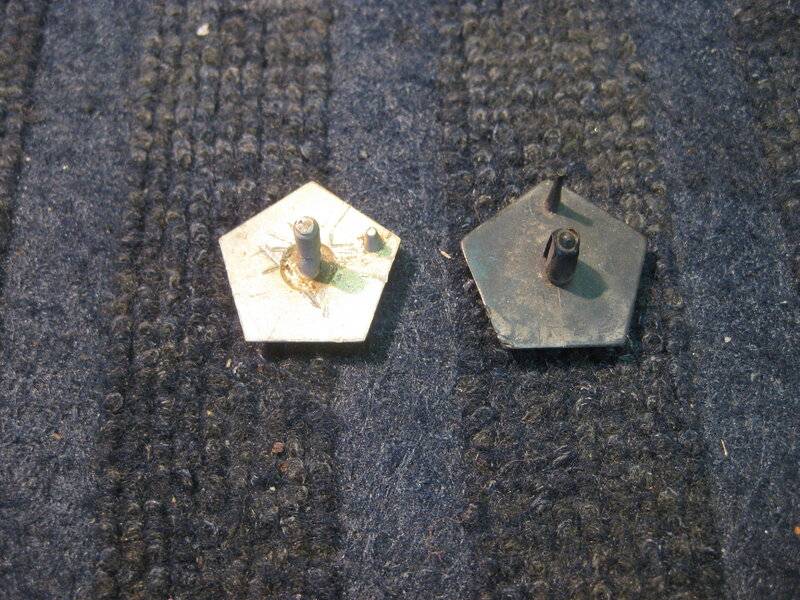

I pulled the plastic backed pentastar emblem off the passenger fender. I thought the all aluminum ones were used on pre 1965 cars, or something like that. Does anyone know what would be correct for 1964?

Ok.... the door plugs. I have an answer. They are to adjust the windows. If you take off each plug and look in, you have a straight shot (with an extension) at the bolts that retain and adjust he channel that the windows go up and down on.
