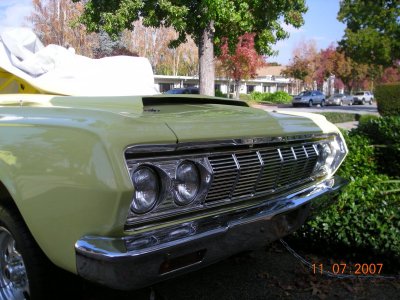

I stripped and polished my 64's grill. A lot of work but nice when it's all done !

I sanded EVERY pit and scratch off of it after I had a metal refinishing shop dip it to take the anodizing off of it. I have used oven cleaner on other pieces in the past and it works fine too. Don't be afraid to sand it. Looks better without a mark on it. I went online and bought some polishing compounds. Bought green, red, black, white. Do some research and see which ones cut more and which one to use for the brightest finish. I used my grinder and bought a cloth wheel for each color compound and marked each cloth wheel with a pen so I would not mix up compounds and wheels. I put 40 hours into the project and I think mine is nicer than any other grill I have seen since. I did not put the black paint on it where it was intended. If you look at my pics you will see that my car has a bunch of subtle changes done to it and I did not want to take all my hard sanding/polishing work and cover it with paint
