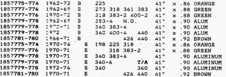

62-72 B-B0dies are the same length.
I put a pair of .920" bars from an R/T parts car into the nose of my '64 Polara, which now has a 440 in it. It rides nice on the road.
Many of us use 1.03" or larger. I have 1.06 in my 67 wagon with 440. Rides great, no more mushy riding. Part that equation is the Bilstein shocks, RCD versions.
i use .92's with my '65 coronet. later i added a firmfeel sway bar. the sway bar really made a big difference in handling.
73/74 get no love again. 43.5”
So if I understand correctly, all the torsion bars that are on B Body Mopar and are 41” long will fit my 64 Polara even though the part description states they are for B Body Mopar 66-69? For example these: Hotchkis Dodge/Plymouth B & E-Body Performance Torsion Bars (Pair)
Yes
I see the table, but I'm wondering if I understand it correctly. I sent a link to the torsion bars I want and I want to confirm if they will fit.
If they are 41” they will fit
