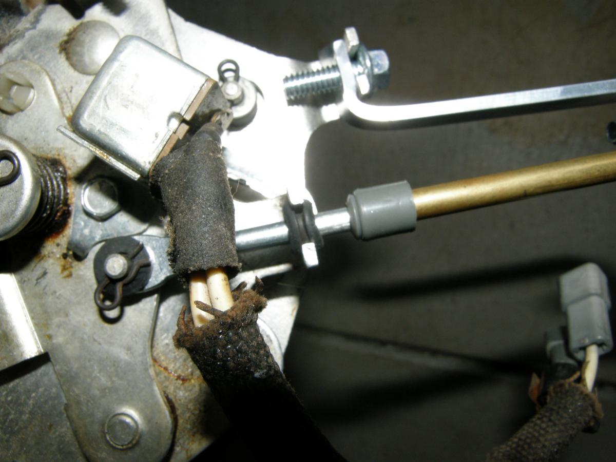

Very simple, easy to do project. Bear with me on this. Get a B&M or similar type cable, make a small bracket to bolt to the cable and then bolt the other end to the shifter. You gotta connect the cable to the shifter first so you know how long of a bracket you'll need. I'm doing this very same thing, but I've got a 545RFE trans (5sp. auot). Ill get some pics posted when it's done, that way you have a better understanding of what I'm talking about.

Almost done with the bracket...need to get (2) 1/4-20 bolts and then it'll be done and I will post some pics.
Here it is all done. You'll notice a black bushing in the eyelet of the cable, it's there to take up the slack between the tit and the eyelet. The grommet is so the cable stays centered and the bracket is self explanatory.

Nice Job 5.7 Hemi. Can you tell me the part # for the Cable?
Also, do you have pics of how the cable is connected to the transmission, does a mounting bracket come with he cable?
Thanks!
Not sure on the cable part number, but you can find it online or at pepboys, kragen, etc. Since I'm using a 545rfe trans, I had to make a bracket to hold the cable at that ens, custom one off if you will, but the ends for the trans are available thru summit racing, jegs or online. Hope this helps you out.

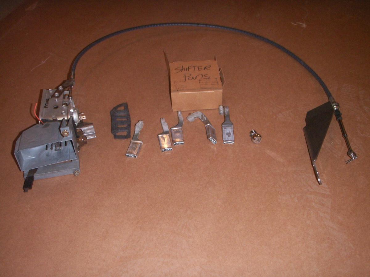

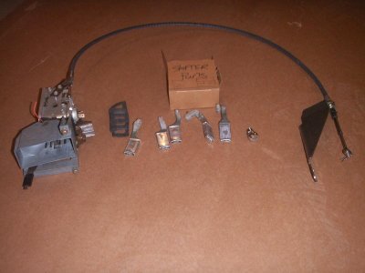

I actually have one of these conversion for sale if anyone is interested.
Still have it Joe? I'm actually going the other way. Gonna put a 64-5 Chrysler? console in a 68 B-body, just because I like the looks, and I really want to save and use that shifter. I'm guessing that's a 1 cable set up with a different shift arm for the tranny?
Imperial Services shift cable kit
I used one of the Imperial Services cable kits on my 65' Satellite with a 71 trans--works perfectly.
Not what you're looking for, but this is what I have.
Push button dash shifter set up by Imperial Services. Single cable set up.
Misc. extra car parts 008.jpg (99.0 KB)
What do you want for it? I have a buddy doing an altered wheelbase 64.
Imperial services part number IS-352, comes with cable, brackets and all. $160.
