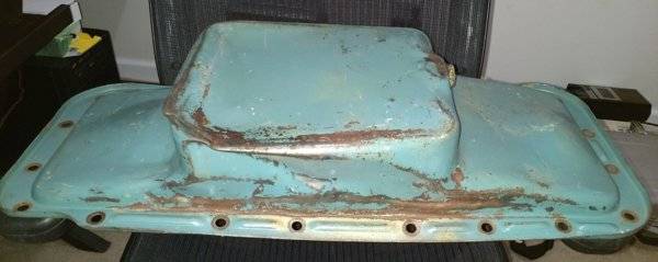

I need an oil pan and pickup for my 383 HP build. The original pan is pretty damaged. Looking at Milodon 31010, Mancini and others.
Any recommendations? I don't want to notch the K Member or have to pan hanging down below the K Member. Stock would be good, but finding one ...

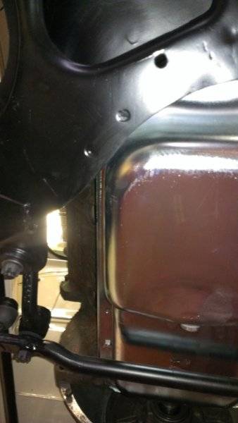

on my 64 sport fury I had to notch the k member with the milodon 31010.

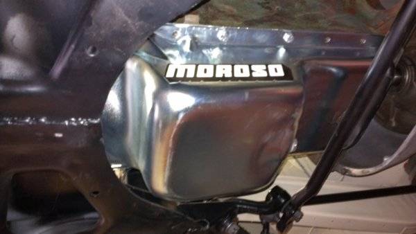

Hey Desotojohn, Welcome to the hunt ! I just went through any channel I could to locate a pan for my '63 build, and the only pan I found, that is currently available, is the Milodon 31010. It will fit the '62-'65 k-members with a BB, but for street use, it hangs 2-1/2" below the frame. I did purchase one, and about to start the mod on it to remove 1" to 1-1/2" in depth from the sump. This will leave about a 6 qt capacity for the oil. All other pans available have been discontinued, due to lack of need for them, according to the venders I spoke with. The pic of the pan is on a friends '65, and is from 440 source, 7 qt, which they NO LONGER OFFER ? It hangs down about 2" to give you an idea of what you will end up with, using a Milodon 31010. Good luck with your build, and drop a source for the pans if you happen to find any that will work on the '62-'65s.

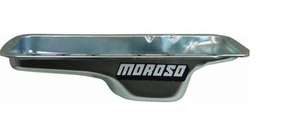

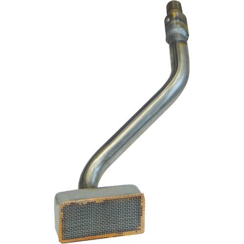

Thanks for all the suggestions. I called Moroso and they recommended their 20766 Oil pan and 24766 pickup. Seems like the front is too deep to clear the K Member.

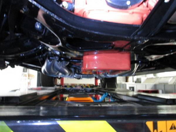

On my 63 Sport Fury with the 440 eng I use a Moroso 7 qt pan I bought from Mancini. It fits perfect and I did not touch the K-frame as I did not modify the K-frame any as this pan fit right in. And you can see it has plenty of road clearance and its never hit anything in the 12 years its been on the road. Ron
Hey Desotojohn, Welcome to the hunt ! I just went through any channel I could to locate a pan for my '63 build, and the only pan I found, that is currently available, is the Milodon 31010. It will fit the '62-'65 k-members with a BB, but for street use, it hangs 2-1/2" below the frame. I did purchase one, and about to start the mod on it to remove 1" to 1-1/2" in depth from the sump. This will leave about a 6 qt capacity for the oil. All other pans available have been discontinued, due to lack of need for them, according to the venders I spoke with. The pic of the pan is on a friends '65, and is from 440 source, 7 qt, which they NO LONGER OFFER ? It hangs down about 2" to give you an idea of what you will end up with, using a Milodon 31010. Good luck with your build, and drop a source for the pans if you happen to find any that will work on the '62-'65s.View attachment 557314 View attachment 557315 View attachment 557316

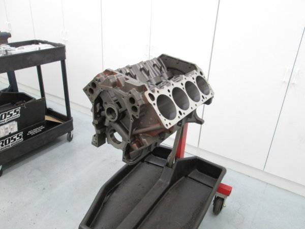

That's one super clean shop !! Ron
