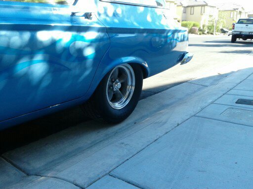

This is a 65...so what I now understand has a wider 8 3/4. But I have 15x8 TTDs 4.5 BS with 275 60 15s on the back, TTD 15x6s on the front with 205 75 15s. Every now and then it will rub on the rear drivers inside fender making a hard right turn.
If the info from the link to the other thread I posted above is correct:
Wider than a 62-63, but not a 64.
If I used a 65-67 I could fit a bigger tire.
I tried 275s on my 64, no way, so it looks like a 65-67 will work.
