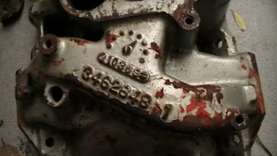

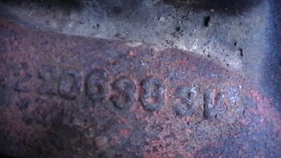

I have a 1965 dodge 318 poly that i pulled out of my 4 door parts car, and real nice roller a 2 door Hard Top coronet on the way. I bought a four barrel cast iron intake at a swap meet in englishtown a year or so ago, after i pulled the engine and i sat both intakes side by side i realized they were completely different bolt patterns, so now i have a crap 2 barrel and a useless 4 barrel. I picked up the cast iron intake because they person i bought it from insisted it fit on POLY 318's, and it was cheap enough i might have paid 50 bucks for it or something like that. Either way i need something 4 barrel or more, 4 barrel, dual quad, three deuce, as long as it fits an A style small block. Any hints on where i can find them even would be a GREAT help! -Chris

Looks that 4 barrel intake you have is for a 69 340. Probably worth some money. I sent you a PM to a link with a nice 4 barrel for your poly motor.

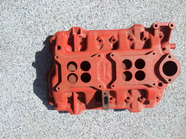

I have a factory dual quad for sale. I would like to get $350 plus shipping for it.
manifold.jpgRegards,

Thank you for decoding that, i have no idea how to do that. I have some pics of the block and heads i eventually need to put up and get decoded too.
See on the back of the intake where it says 10369? That's the date. 10-3-69 which is actually correct for an early 1970 model year 340. Those intakes get some nice money on Ebay. If it was mine, I'd blast it and prime it and sling it on Ebay. You might be surprised.
