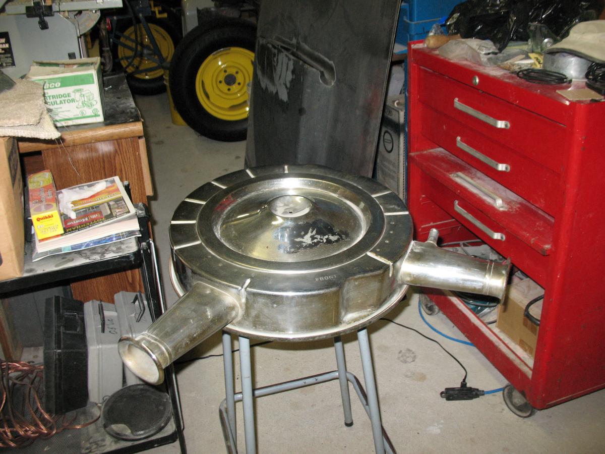

Here,s one I have from a 67 383 4 barrel
That was on a 383? That looks like on for a 67 R/T or a 67 GTX. That one is bad ***. That would look great but, if you are going for period gorrect I guess not. I've even seen the small one on a 66 Satellite 383 car. It was all original also. Original owner letting set outside sinking into the ground. I don't get it.
@Beezee: that's not period correct for my car. That's for sure. The snorkels are tapered and that's not correct for 65.
