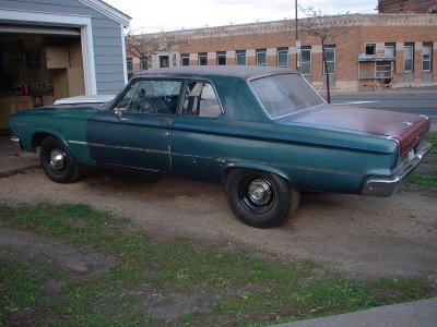

I did the same thing as you. 67 b-body dana , inboard springs and no tubs. 15x10 steel wheels with m&h dot n50/15 tires. 28.2 x 12

I have 15x10 w/6.5 bs. I wouldn't go any bigger than a 13.0 section width. I have offset hangers and my 29x10.5w are tight with a 13.2 section width. Before I changed to the 15x10 rims I had 15x8 w/5.5 bs steels with a 28x10.5 Hoosier slicks no clearance issues

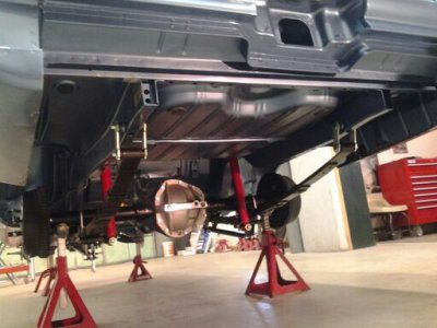

15x10 steel wheel, with a 3.75 back space. SS springs were installed inboard , front 20" seg. was placed so that tire would be centered in opening. Perches were welded to help fit the tires.View attachment 117029
