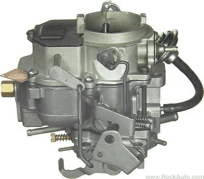

For example all the carbs shown on RockAuto for a 1975 are really simple.

I stand corrected....thanks....I was thinking of the Electronic Lean Burn system, but it did not use O2 sensors, but it had 2 distributor reluctor pick ups....one for starting the second one used by the lean burn system. Yes, the Carter BBD pix is a very simple carb that is very reliable IMO. It looks as if for '71 and newer for the evaporative control system.
