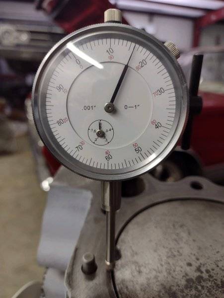

I didn't figure actual compression ratio on my 67 383 4bbl engine that went back together with original stock pistons and 516 closed chamber heads, but the pistons are 16 thousandths in the hole.
I don't know the compression height of either year piston. Nor do I know what heads your 65 engine is running. I am only assuming that the 67 and prior 383's were closed chamber heads. In 68 the heads on a 383 went to open chamber 906's, therfore to keep the same compression ratio the compression height was changed to maintain the 10 to 1 advertised compression.
I didn't figure actual compression ratio on my 67 383 4bbl engine that went back together with original stock pistons and 516 closed chamber heads, but the pistons are 16 thousandths in the hole. View attachment 1333902
That sounds about right with the factory metal gasket. Just don't use 516 heads on a 68 block without checking piston deck height. If need be, a thicker head gasket will give the required clearance.
