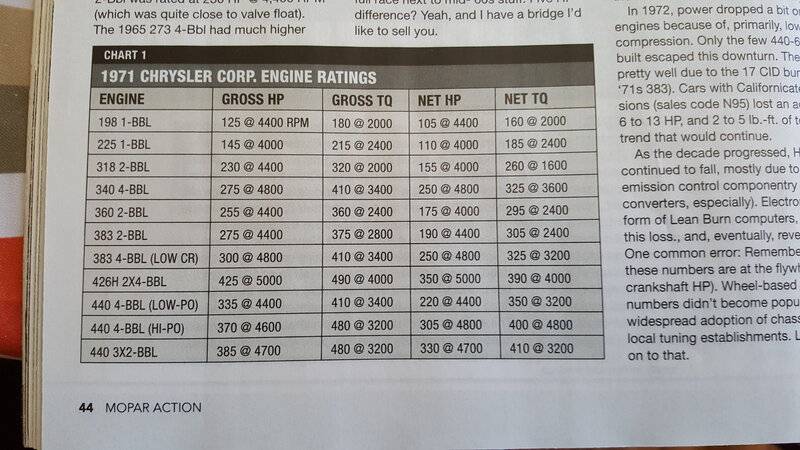

He goes on to offer some proof of the factory fudging with the HP numbers, by showing a chart from 1971 when Chrysler published both gross and net HP ratings,( engines were unchanged) and comparing the 318 vs the 340's numbers.
The 318 lost 33% of its HP rating from gross to net, but the 340(claimed to be underrated), only lost 9%
This looks to lend creditability toward the fact that the 340 WAS underrated.

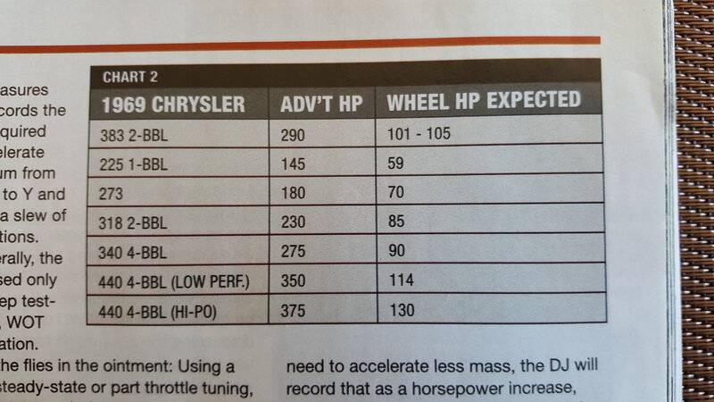

Here's your reference charts, they are Chrysler's own data.

The chart#2 is not Chrysler, but published by Clayton, for use with their dyno.
It also goes on to say how the Clayton dyno was not so good at reading HP, more a testing tool, to replicate road conditions, as this was one of the first chassis dyno.

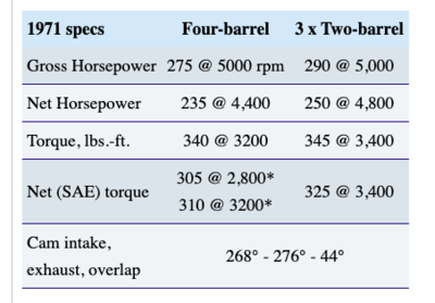

For '71 chart, the gross torque for a 340 and a 440 (low-performance) are both 410 at 3,400. Hard to believe that is accurate.
1971 340 per Allpar:
Also the 383 4bbl LO CR is at 410TQ, good catch Dibbons!!
I could be more of "fudging the numbers"
If you look the 440 HI-PO makes 480 @3200rpm
the 440 lo-po is [email protected], generally, not always, but most of the time, the low-po offering make MORE torque then the hi-po at a LOWER rpm.
It could be the lo-po, did make more torque, but perhaps, it came on at 2600rpm, and by 3400 was falling way off peak??
Is so why would they rate it at that rpm? They MUST have a reason, maybe to upsell customers to the hi -po version??
All this just goes to show how valuable a real dyno of the stock spec engines, could be.
