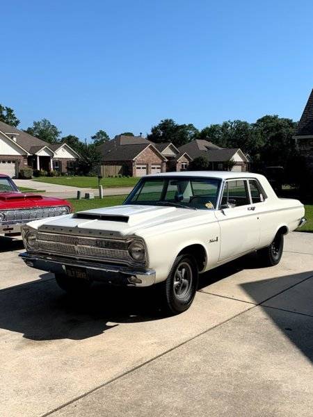

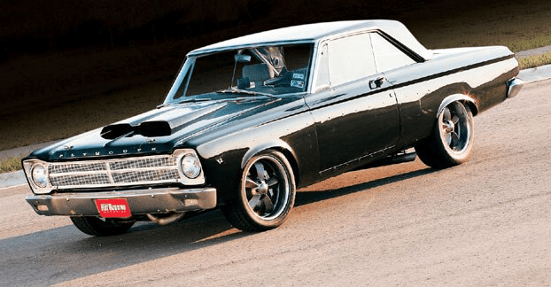

Looking to get a new set of rims and tires for my race car which I will soon drive on the street
Open to ideas and would like some advice on rim and tire size front and back.
Currently have 9.0/30/R15

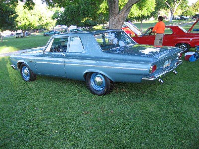

15 inch steel wheels that can accept the original 10 inch dogdish hubcaps. Sizes depend upon the look you want and how much room you have , wheel tubs and such.
Frank
I converted my 65 back to the street. Right now running 275/60/15 Goodyear drag radials on rear with 7'' steeles. On the front is 215/75/15. As you know if the rear wheel wells are stock (mine is )you may be able to go a bit wider.I also have American torque thrusts with 255/70/15 rear and 225/70/15 front. Those are 7'' wheels also. My 2 cents.

My wheel wells are stock with the Hoosier slick I’m running the drivers side is very tight not sure the width of my rim but slicks are 9.0/30/R15

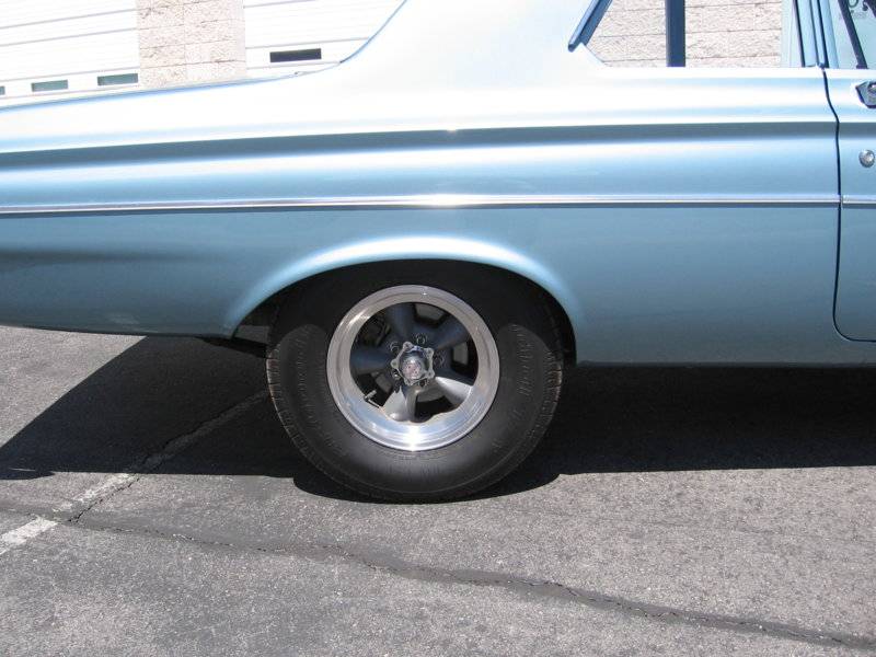

I have long studs wondering if that will work / look okay with the torque thrust wheels
Take a closer look of the rear wheel photo. Yep, long studs.

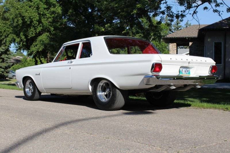

Like you said about your car having a tight fit on the driver side, My 63 Belvedere was tight on the passenger side.The rear tires that are on the 65 are tires I bought for the 63.Plenty of room on my 65, too close to run on my 63.
Typical Mopar manufacturing tolerances.

Agree with vintage torque thrusts upfront! Best look for a 65!
15 x 4 torque thrusts up front 15 x 6 steelies (10" centers) on back!
