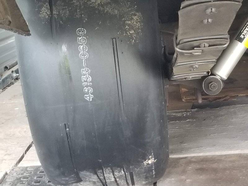

You want 4.5" to 5" of back spacing on the wheels. 5" of BS might be close to springs. I had 7" wheels 4" BS and L60 x 15
inch wheel rubbed on corners. You'll have to convert L60 to modern size tire. I'd run 8" wide wheels.
15x8 rear with 4-1/2" backspace 245/60 tire
15x7" front 4" backspace 216/65 tire
15x8 wheel with a 5 inch backspacing will allow you to put 275/60/15 tire on back
