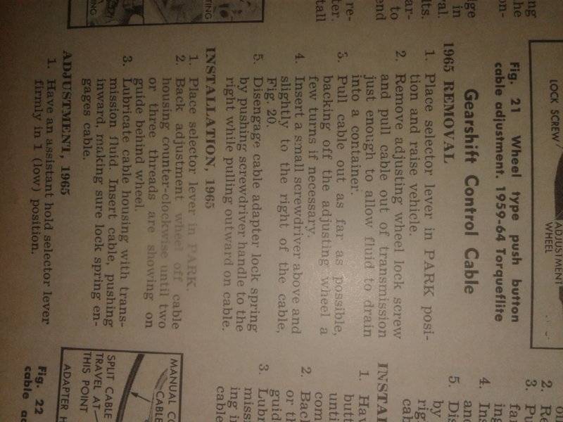

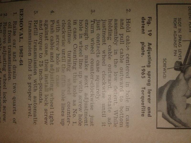

See if this helps. If need be I can try to get better pictures. Motors auto repair manual 1966 edition. I used these books to adjust my 63 push button trans. Worked fine.
View attachment 670708 View attachment 670709
Thanks so much- going to give it a try
Maybe I confused the issue. The cable I am adjusting is not a pushbutton. It is a console shift. ????
The difference in the factory cable adjustment procedure is that the PB adjustment is done in Reverse while the console/column is done in 1st. If you try to use the PB procedure on the console/column there is another gear (Park) beyond Reverse, so you'll be one gear off.
But as long as I use the console link you sent I should be right,,,right?
