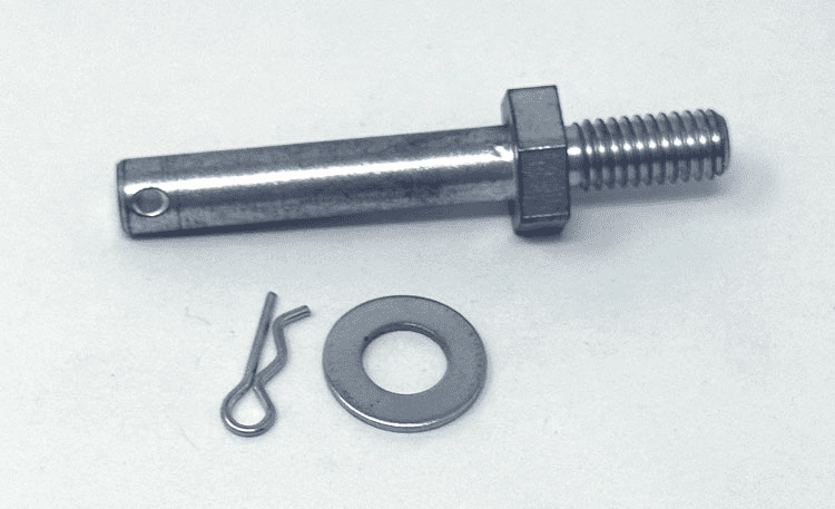

I finally got a stock throttle linkage for hooking up a six pack to a 727 throttle valve which will replace my bouchillon cable. I can figure out the top bellcrank mounting but where does the bottom bell crank bolt to? The factory service manual is not very detailed on this.
There should be a pivot shaft on the bell housing area of the transmission, where the arrow shows..
Thank you Wild R/T I got it installed this weekend, the headers caused some issues so I cant use the stock pivot but I got it in there. I didn't realize there are two pivot points on the 727 housing. OEM linkage works so much better than a cable on the 6 pack thanks again.
