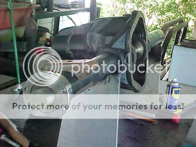

whats a good way to check for twisting? I have a late 60's 8-3/4 that I was thinking to swap into the 64. This rearend saw a fair amount of street racing according to the PO. It's up on stands at the moment.
I work off of a 1/2" thick steel table. Didn't build it just for rear ends but it works very well for them. The bearing housings are not flat all the way across but if you clean them and they are flat enough for a magnetic level, you can get an idea if they are the same or not. You can also put a level across the studs and see if they correspond with each side. If you have a table like this, you can also square the opening of the center section to the table and check the angle of the spring pads and see if they are both the same. I've found a few housings where someone welded on new pads when they moved the springs in and just laid the housing on the springs, adjusted the pinion angle and welded them up. Doing it this way is wrong and especially so if you're using SS springs or any other biased rear springs. Levels, angle finders and squares are just some of the tools that should be used in building/narrowing/checking a housing....
