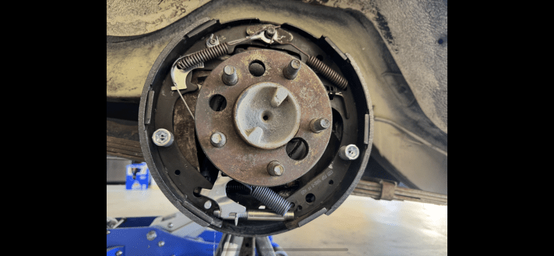

So confused….

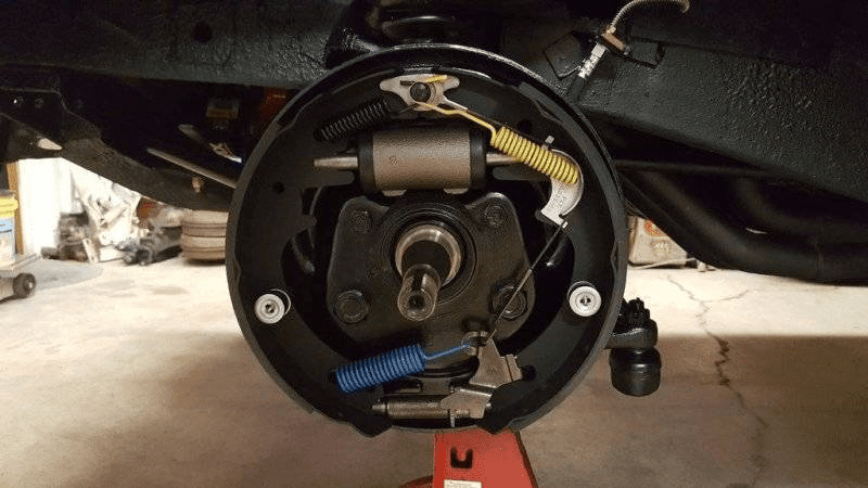

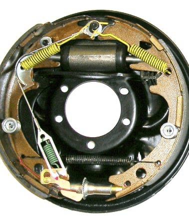

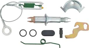

Last photo is manual adjust brakes. I assume you meant to make them self-adjusted. The lower spring needs to go into the big hole in the lead shoe. I know it doesn't look right, but, just loop it through (what looks like backwards) and it will stay. On a side note, make sure the cable guide hasn't slipped out of the hole in the shoe when you installed the spring. It's a common problem and the self adjuster won't work correctly if it isn't properly in place.
