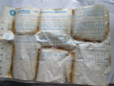

Forgot to add it has all the paperwork including the broadcast sheet, I have no idea what any of that means lol

Well I decided to get it, I can anyone interpret the build sheet? Only thing I can figure out is it’s a Satellite with medium turquoise paint and a two tone turquoise interior
