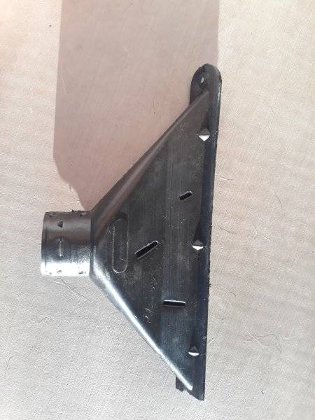

Actually i need 2 of them.
Pass side on 2 cars .
Really dont want to buy repops as i don't have a need for the drivers side

THOSE will work, as I dont know if I still have the broken piece or not

Bill, yes. same air duct . My cornet is the same exact broken piece.

I hope that's not the one I repaired for him? Judging by the missing piece and the sight of a lack of repair, I'm going to say NO. If you have the tab it can be repaired with a piece of Kleenex or T.P. and some super glue. PM me if you want to know more on how to do it. Good Luck
No signs of a previous repair.
I have a set of the body shims waiting on me and will go that route for repair .

With having 2 cars with the same exact broken duct. I didnt want to spend 300 on the repops if i didnt have to
