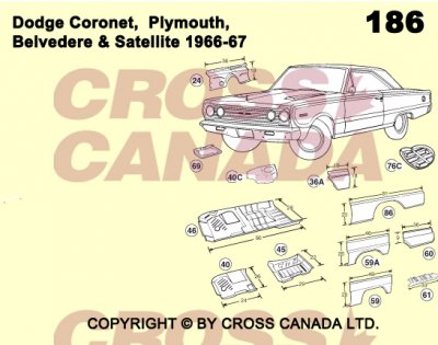

I got mine from yearone. I dont know who made them, but body guy didnt say he had any problems and i think it looks darn good
