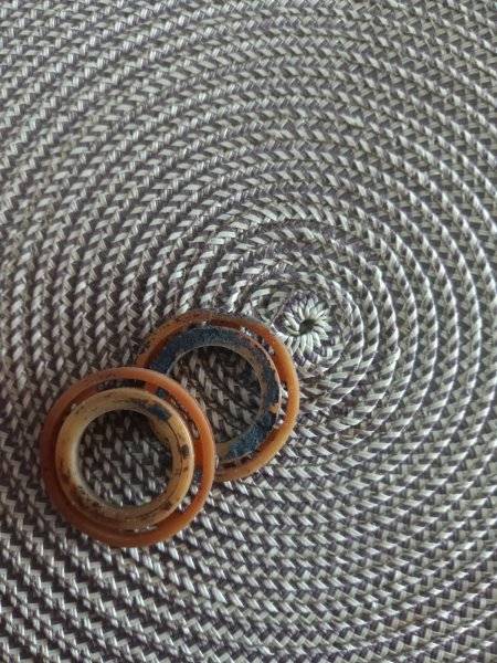

I have these two little discs that came out of the column somewhere. Would you know where they are supposed to reside?
Looks like on top and below the bearing or actually part of the bearing but this time I really don’t remember if I’m not right
I thought so too, but the bearing has the c clip on the bottom and same on top of it. I didn't want to crush those discs. Thank you oldkimmer
