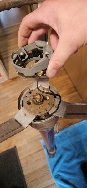

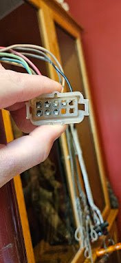

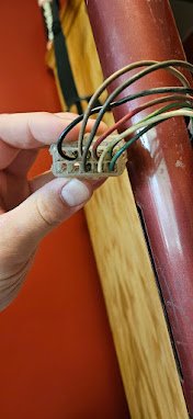

Start by pulling the pins out of the plug. There is a tab on each side that needs to be compressed then the wire pulls out the back.
Next off comes the horn pad. Quarter turn Counterclockwise and it pops right off
This is what's underneath

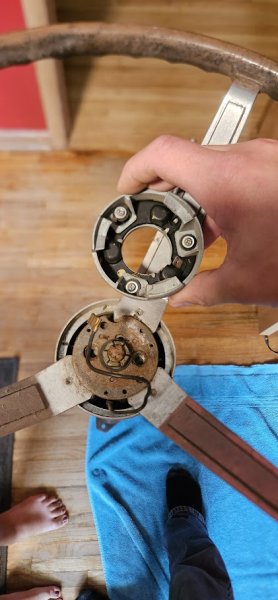

3 Phillips screws later and the pad mount lifts right up

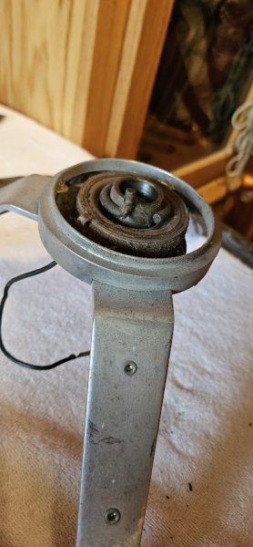

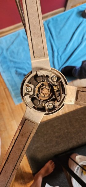

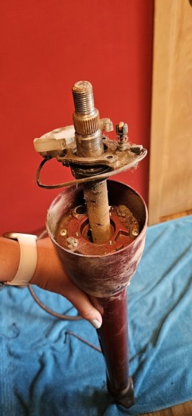

Next is to pull the steering wheel off. Using a basic puller not pictured the wheel popped right off with no issues

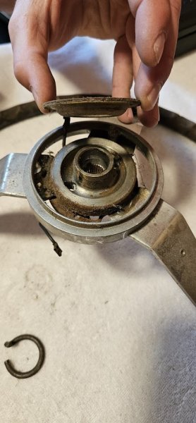

Under the wheel is the horn contact ring there is a spring style retainer that slides off and the contact pad lifts right off after that

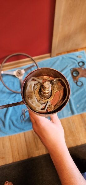

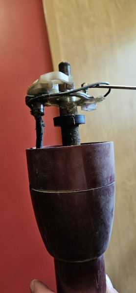

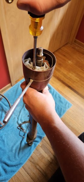

Once the wheel is off you are left looking at the turn signal switch. The plan is to clean up the original switch and reinstall. did not want to spend the money for a N.O.S switch or buy a junk repop.
The screw going through the center holds the Turn Signal Lever to the Turn Signal Switch
Once the lever is off there is a small retaining plate with 3 small Phillips screws that holds the turn signal switch down.
Once the screws are removed the switch slides up with a little persuasion.

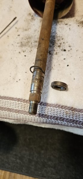

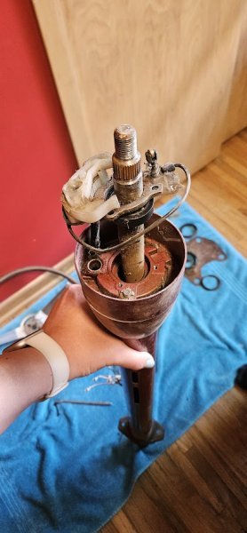

Once the switch is out you can remove the upper column bearing. there is a rubber cover / seal that goes around the bearing and seats it in the upper column housing.
There is a snap ring on the top side of the bearing and a half ring circlip on the bottom side

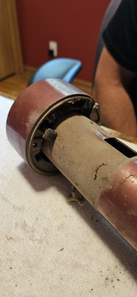

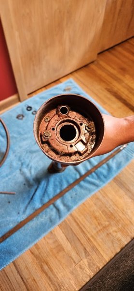

Once the bearing is off you are looking at the mounting for the upper and lower column collar
The 2 nuts hold the upper collar to the column housing while the 2 Phillips screws hold the lower collar to the upper collar
Remove the 2 Phillips screws and you can see the bottom of the upper collar and how the 2 square head bolts hold the collar to the housing tube
Once the nuts and square head bolts are off the collar pops off with a little tap of the hammer

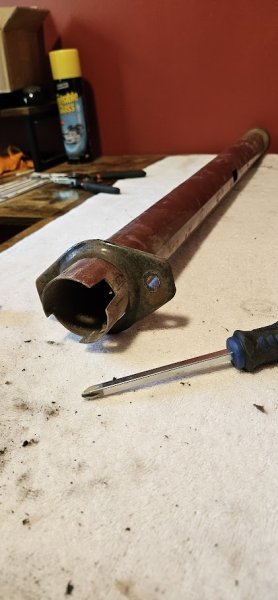

Last thing off of the column tube is the upper half of the firewall mount
This is the last piece off and must be the first on because the bottom of the tube has a tapered flare that will not allow it to slide down and off.

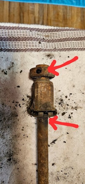

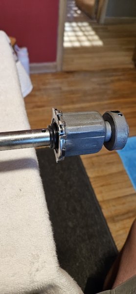

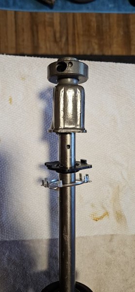

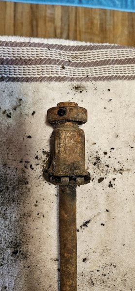

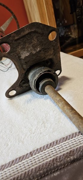

Lastly is the steering coupler which connects the column to the steering gear
1966 is a different style compared to the 67-70 couplers
The top cap/seal is pressed and held on with tabs that are folded over the main coupler body
Pry these tabs up and the top seal will slide right up and off the coupler

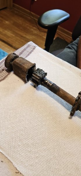

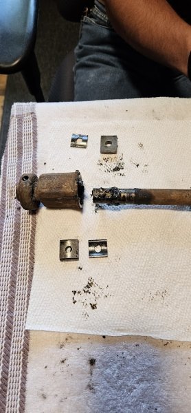

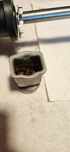

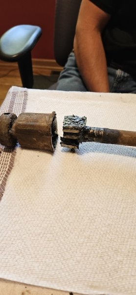

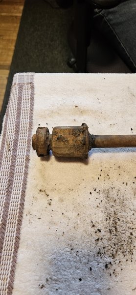

On each side is a metal shoe and a spring that holds tension apart. The grease was old and hard and dry at this point.

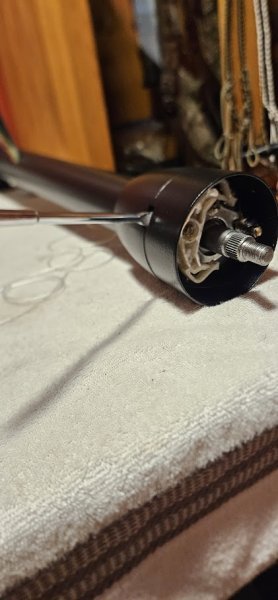

There is an alignment hole on the shaft and the coupler body to align everything together during assembly. The marks are hard to see with everything rusty and greasy

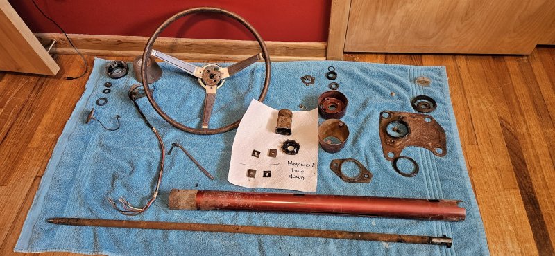

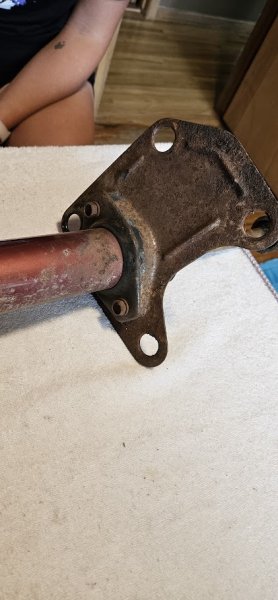

That brings us to where we are now. Everything is disassembled and laid out. Next is to sandblast the tube, shaft, both collars, firewall mount. Clean all the other parts and hardware. I will update here when assembly takes place / is complete

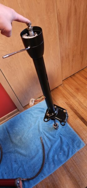

This weekend I was able to assemble the column as far as I could. I have not decided what to do with the steering wheel yet so that and the horn button will remain off for now. During the week I sandblasted all of the metal parts. The column tube and housing sections were painted with a light dusting of texture coat to give it the factory look.

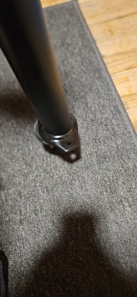

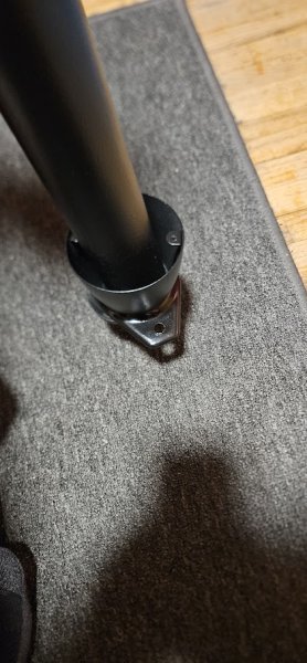

First slide on the bracket and plate that mount the column to the firewall

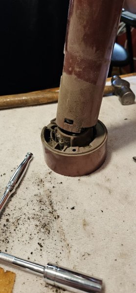

Then the lower housing needs to slid on

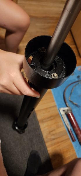

Then the upper housing
Using the 2 Square headed bolts the upper housing can be secured. Making sure the heads of the bolts catch the slot in the column tube

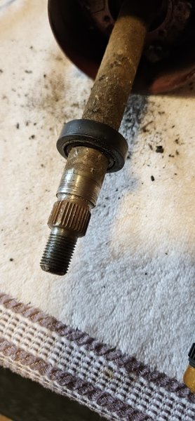

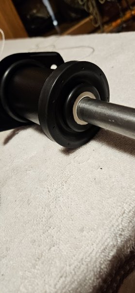

Next the steering shaft can be slid through the tube and housing. Make sure the seal and retainer for the coupler is installed on the shaft as well as the lower seal for the column tube

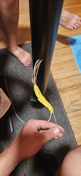

You can now slide the turn signal switch down onto the shaft and into the housing. Fish the wires down into the tube. Make sure the lower hosing section is above the slot that the wires exit the tube

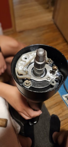

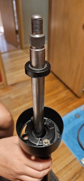

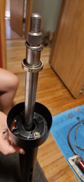

The lower circlip, bearing and upper snap ring can now be installed as well as the bearing rubber cover
To install I placed the bearing in the oven at 300*F for 20 minutes or so. When I went to install the bearing it went right into place with just a couple light taps with a small hammer
After the bearing is installed you can slide the bearing and rubber cover down into the slot in the upper column housing. Then the retainer that holds the bearing and turn signal switch down can be fastened with the 3 Phillips screws

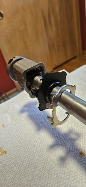

For now I am done on the top side without having a wheel to install. Last is the coupler

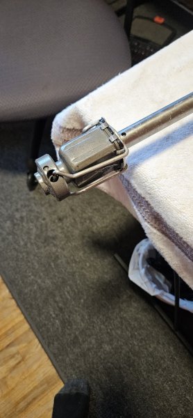

Partially fill the coupler with grease.
Set the shoes and springs on the pin that goes through the bottom of the steering shaft. Make note of the alignment hole in the steering shaft.
I used a dab of grease to hold the shoes to the shaft
Add more grease to the coupler if needed but do not overfill

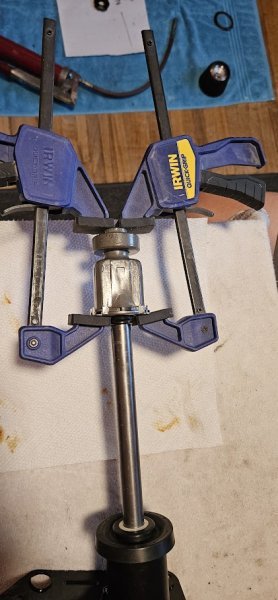

Lastly is to reinstall the seal and retainer. I used a pair of clamps to hold the retainer tight while I set the teeth on the retainer
Using a hammer and chisel you can fold the teeth of the retainer over the edge of the coupler to hold the seal in place.
For added security I also chose to go with the aftermarket retainer clip

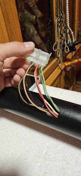

You can reinstall the wire harness plug. Be sure to bend the tabs that secure the wires out a little bit before pressing the wire into the plug

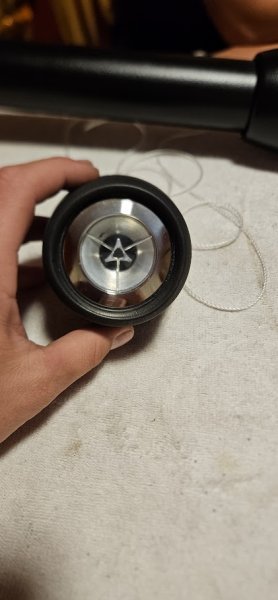

Column is now complete until the steering wheel is added which includes the horn ring and button
