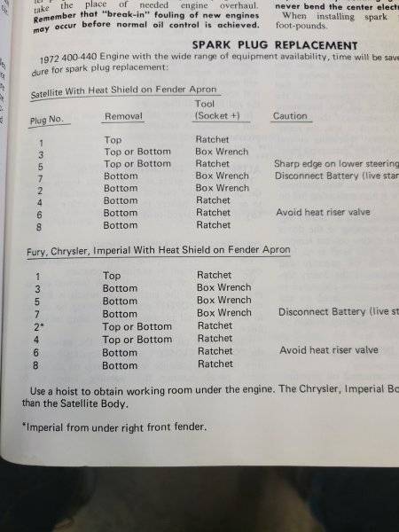

Sometimes the spark plugs are easier to do from underneath. I have a spark plug socket with 3/4" hex on its end that works well with a box end wrench. On the passenger side, I unbolt the lower alternator bolt, unhook the belt, and swing the alternater up out of the way, and can reach most of the plugs by reaching down through there. The negative ground cable should bolt through carb return spring bracket on the front intake bolt hole.
Not sure if there's a chart for 66's

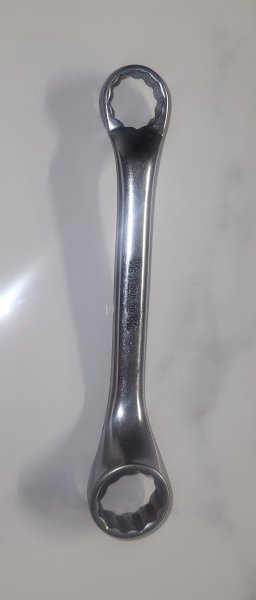

With stock manifolds, IMO , Its easier to do them all from underneath , I have a 6 inch offset box wrench just for that

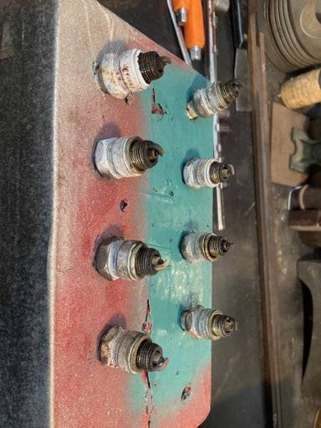

I HAD to do them from the bottom. The power steering box and oil dip stick were really in the way. Fortunately I have an in ground lift. Don't do well lying on the ground anymore. Even so these were the most difficult I have ever done. Have large hands too and that did not help the situation. I have 8 MOPAR P34P plugs old stock plugs but could not find a cross reference from the stock Champion plug. Believe they might be a hotter plug looking at the electrode. So went with the J12Y's. I'll post a picture of the plugs I took out as soon as I download the pictures. This was supposed to be a low mileage car but has over 107K on it and maybe/likely more.
Pictures of the plugs that came out showing some engine wear. The gaps were out to .040 so had been in there for awhile.
