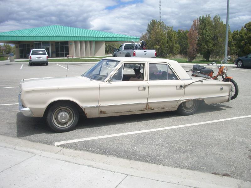

Here are some pictures of my driver. 1966 Plymouth Belvedere 1.
Hauling my bike 1300 miles. 80 miles an hour the whole way.

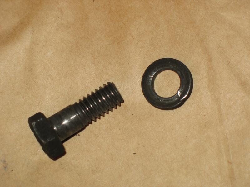

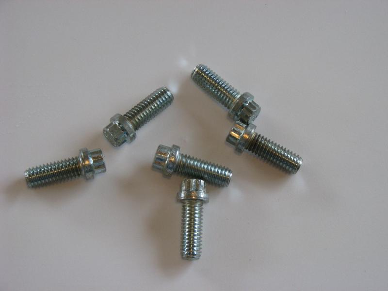

ALSO, do you know where to get these "special" bolts?
Are these special enough??
They are listed on ebay, item # 320899334192

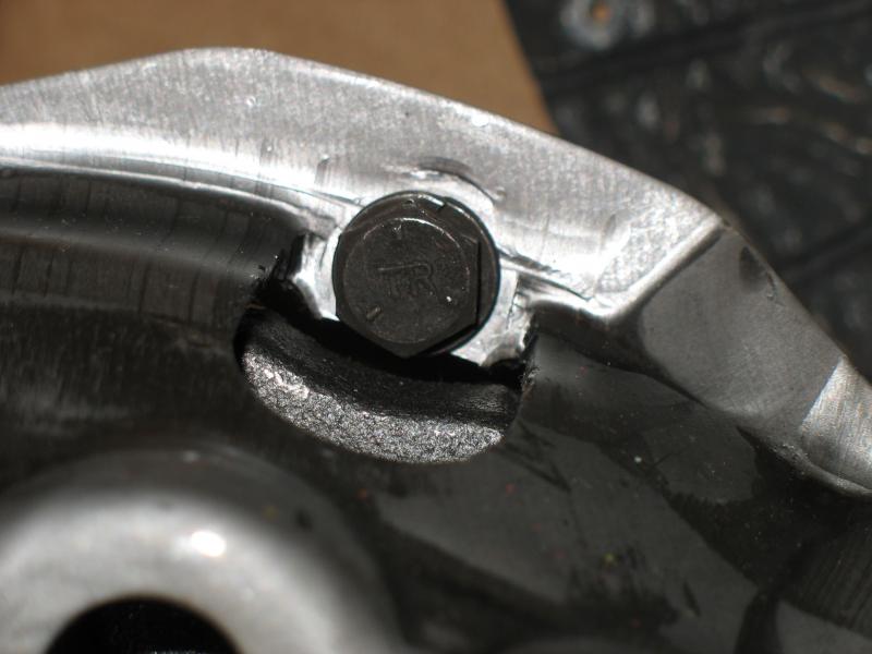

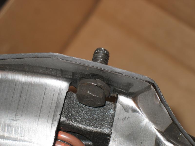

What is the reason that I need special bolts, is it because my stock bolts might hit the clutch pressure plate, with the bolt heads?
See attached pictures of my bolt and my 10 inch pressure plate.
Maybe I don't understand, I thought the special bolts were because the bolt head would not hit the pressure plate.
- Is it because the bolt itself might cause problems with the clutch disc?
What is the exact reason for requiring special bolts?

I got the clutch mounted with my special bolts, looks like the clutch disc would have hit the original bolts. This car is driving AWESOME!! Sad thing is I just found a 3 speed with 4th as an over drive..... Now I am putting in a different trans. Will get my new transmission in about a month.
