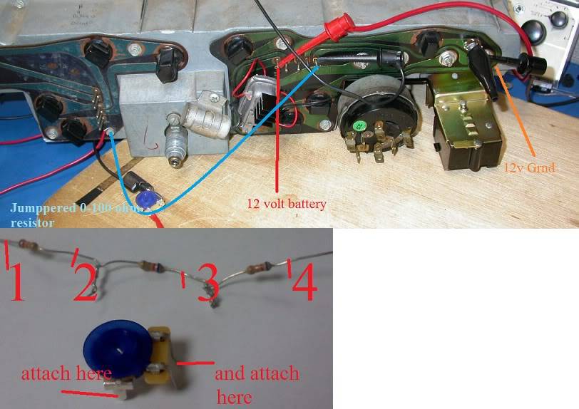

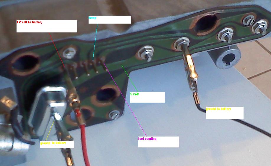

I tried doing a bench test to see if I could ground out my fuel gauge... see the pictures below. I the needle did not move... I looked for 5v when it was connected to the battery I saw no voltage.
(note for testing purposes I did not connect the mercury switch to the 12 volt.... I also hear a clicking when I have this hooked up I read this is normal and is the opening and closing regulating the 5v, but again no 5v from that lead when connected.)

I think I might have figured it out...
I metered out my board for continutity and found that when I checked from the ground to the 12v I was not seeing any... which is good.
Then I check from the 5v side and saw continutity which means it was grounded out.
When I pulled the dash out I cleaned up all the dirt and grime in it and I removed the board so it could get degreased and cleaned up. When I put it all back together the recessed slot (where the voltage regulator goes...the brass clips) is too small. If you are not careful when you put the board down it is possible to touch the case with the 5v side which shorts it out.
That being said I still do not see 5v off of my replacement voltage regulator from rockauto... I am guessing I fried it... I do hear clicking but not a lot in a consistent manner. So instead of ordering a new one I spent 8.00 at my local radio shack turned it into a solid stated voltage regulator. I did a bench test on this one and when I apply 12v I see 5v (4.97) on the other side.

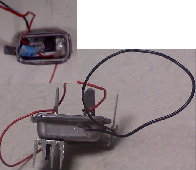

I parted my oem regulator out, and placed the solid state regulator on the inside top. I hope to test it tonight, and will update the post tomorrow (If I get to test it tonight, because my sis-in-law is having a baby today)
That was my issue as described in my prior post.... my gauges work!!!
As promised here is the pic of the new solid state regulator.
Used some hightemp silicone since my cap is sitting in the case... I didn't want to ground anything out. I also put some medium strength locktite on the screw to the heat sink. I drilled two hole in the case to send wires out, and used hot glue to stop the wires from rubbing or shorting on the case... the third wire goes out the PCB board.
I also drilled holes in the metal posts to wrap the wire around... all I have left to do is throw a little solder on, and I am all done, and ready to put the dash back in again.

I wanted to update this post incase anyone else wants to test their fuel gauge.
See pics.... If you use the reisistor, use a 6 ohm attach all 3 togethr then your leads to 1 & 2 = 6 ohms full tank then 1 & 3 12 Ohms than 1 and 4 for 18 ohms, or you can a 0 -100 resistor and test that way. I hope this helps someone.

If you use a solid state regulator like that, be sure to heat sink it really well and have a very solid ground. Those regulators, in this application, can easily dissipate 5W and there isn't a lot of air flow back there. Also, it is possible for that type of regulator to fail in a way that passes 12V straight out the 5V terminal. This will fry your gauges pretty quickly. The unit from RT Engineering provides lost ground protection and a nice blinking light. It also pulses and has a warm up period like the stock regulator. Having been through a few linear regulators, I like the RT piece better. It's not cheap though.
After you've rebuilt your gauges due to a failed linear regulator though... I won't go back.
The reason the 5V regulator might tend to read low is that the stock one is not 5V average. It's more like 6 V average, and the pulsing action has a better effect on the mechanical movement of the needle than a static 5V.
