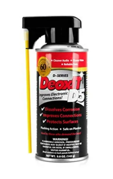

If a dimmer can do it, I would recommend hose it down with deoxit and work it a couple dozen times. dries without residue
