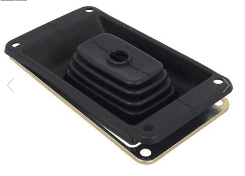

Here's what they look like in pieces. Might be a broken cable. Loose nuts on the rod and levers assemblies can cause sloppiness.
