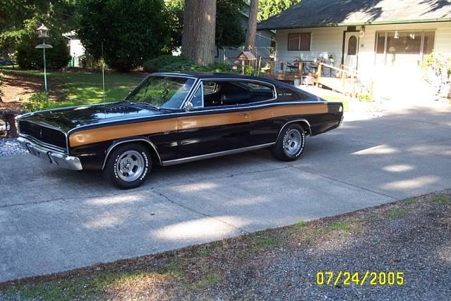

What size rims and tires are you using?
Black car has 235-60-14" on 8" wide wheels on the front, rear is 255-60-15" on 10" wide wheels.

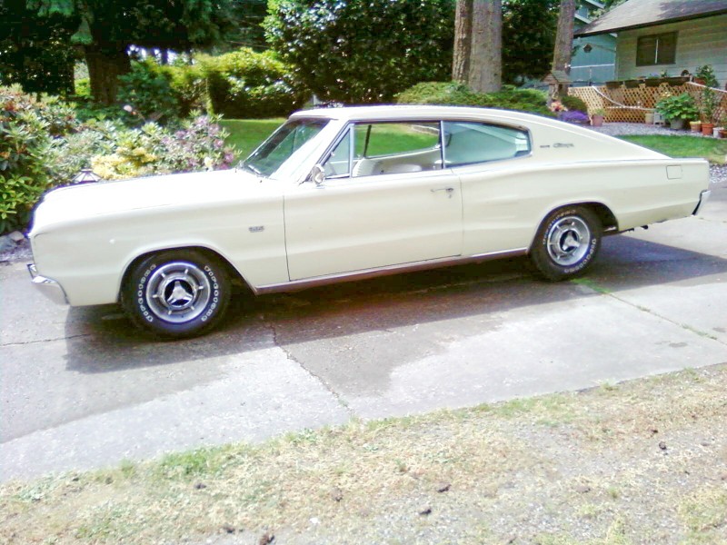

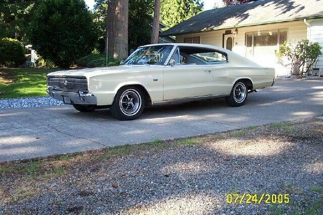

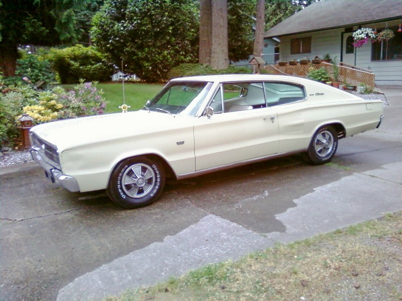

Cream car is running 215-75-14" tires on 6" wide Magnum 500 wheels....which are going away in favor of the stock steel wheels and the stock 66 spinner hubcaps or the Dodge "Mag" style hubcap....I will be running 225-70-14" on the car soon
Sorry to disagree, Cragar SS wheels look GREAT on any B Body! Go for it!
And the Magnum 500 wheels are off...sorry for the crappy cell phone pics
