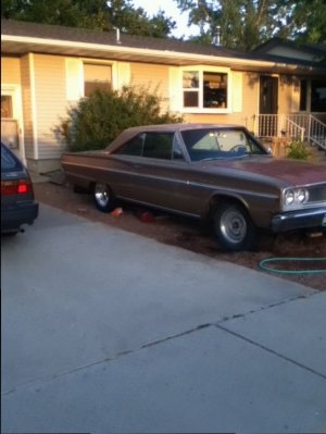

...and we need pics of the car.

You have a major problem though that you have overlooked, I'm hoping its an oversight and not a blatant disregard of the forum decorum... I would suggest that you rectify the situation asap!!! To avoid any retribution....
Post some pics Nate!!! Come on!!!!

Ya just an oversight on the pix. Will try to get some soon. Don't have any good ones of it in its current condition. Thanks for the warm welcome. So far, everyone has been super helpful. This forum seems to be a great resource as this is my first time doing any serious work on cars. Thanks for the help!

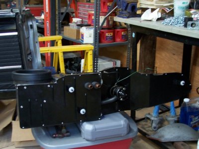

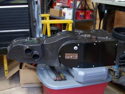

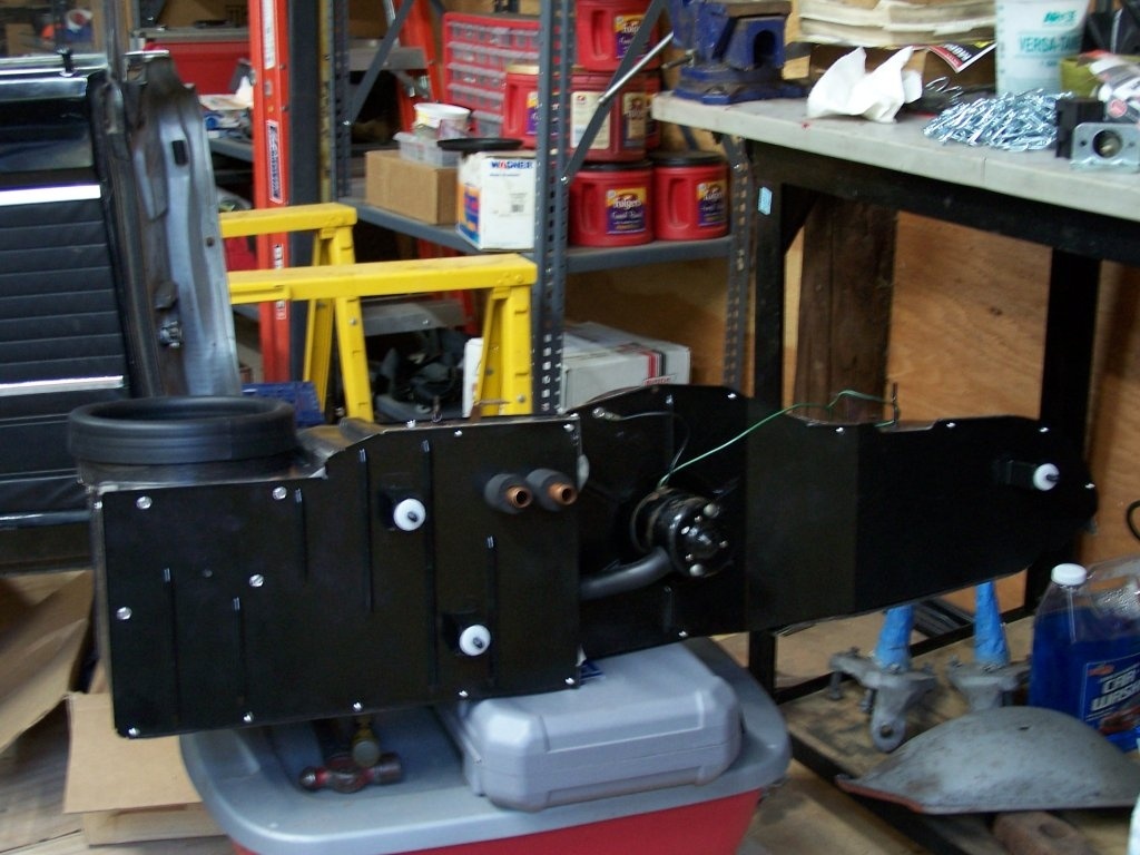

In order to get the mouse smell out you will have to remove the heater box and clean it. Once you remove the heater box you should be able to stick your hand up through the hole into the cowl and clean all of the debris out. More often than not the crud is built up so high around the "dam" that keeps it from running into the car that it won't drain in the corners as designed. You can buy any of the jute firewall padding, heater box foam, etc. from a company called Detroit Muscle Technologies. If you need and heater box stuff shoot me a PM, I have several parts boxes to borrow from.
Jeremiah- I took the heater box out on sunday and I couldn't believe how bad it was. Mice had made a huge nest in it and it smelled absolutely terrible. Also, I cleaned out those cowl vents and they seem to be working great now. If I need any parts, I will keep you in mind! Thanks!
-Nate

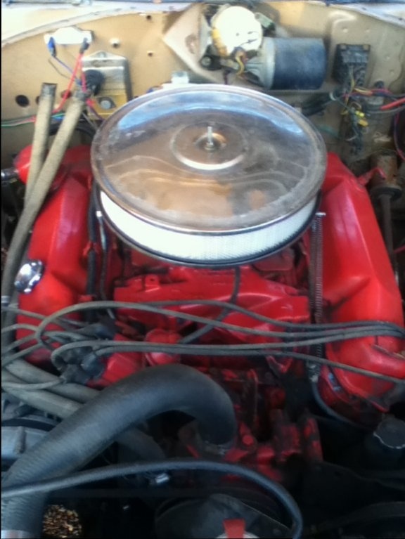

Looks like "YY1" to me.
No, not an original big block. It originally had a 318 poly when my dad had it as a kid. It was raced a little so several engines have been in it but this is the last one. 400- mild cam, 4bbl, headers, dual exhaust. It is copper and black. I will get some pix when my interior is back together.
