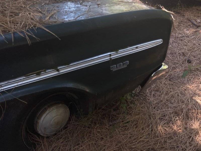

If I recall correctly, my 66 500 had "383 four barrel" badges, the meaning is obvious
I have seen "Hemi" which is also obvious
I have also seen just "V8" which I assume could be 318 poly, or 361. Any other possibilities?
and I have seen no badge at all. Are no badge cars slant sixes?

That is correct.
VIN C, 225- no emblem
VIN D, E, F, 273, 318, 361- V-8 emblem.
VIN G, 383-4 (only a four barrel available in 66)- 383 FOUR BARREL emblem
VIN H, 426- 426 HEMI emblem.
