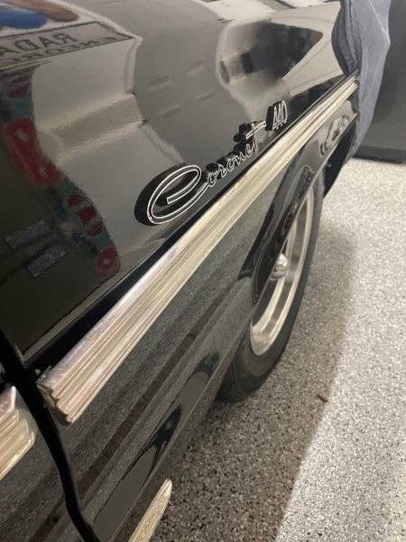

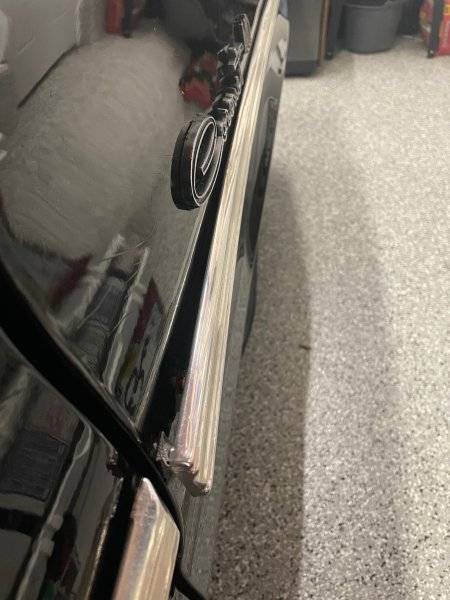

i cant seem to find a clip that will fit the passenger side front fender trim molding
anyone have any idea where to source? doesnt have to be OEM, just something that works

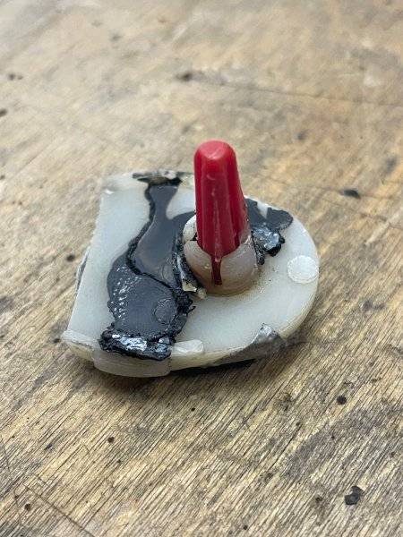

this is what was on there, but doesnt work anymore
I'd carefully remove the trim to at least the next clip...
...and swap that working clip onto the rear of that trim.
At least you won't be in jeopardy of the door ruining the trim.
