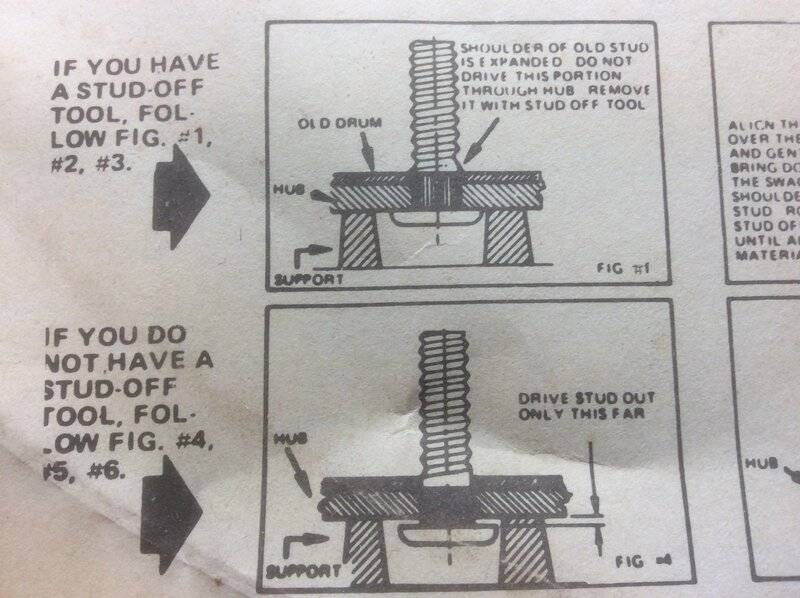

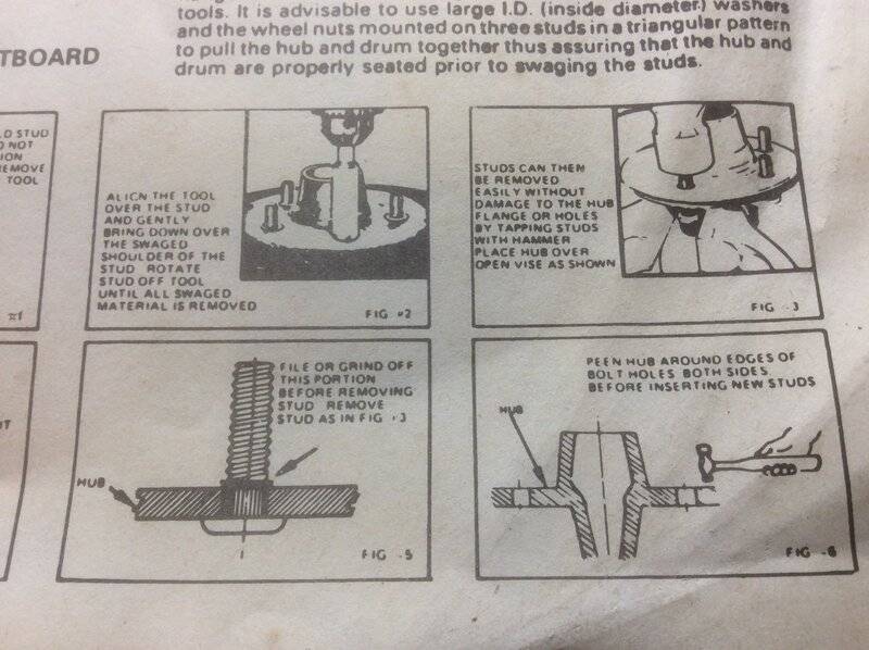

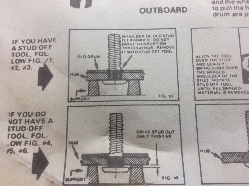

Here's some directions on removing studs. pictures aren't in order.
