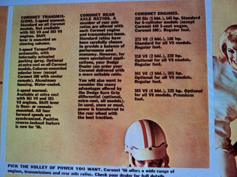

Thanks. I did not know they didn't come with 440 option.
Thought no 440 in factory shoop manual was a 1st year misprint.
Downloaded a 1966 Dealer Brochure, no 440.
My restoration is officially a retrofit.
