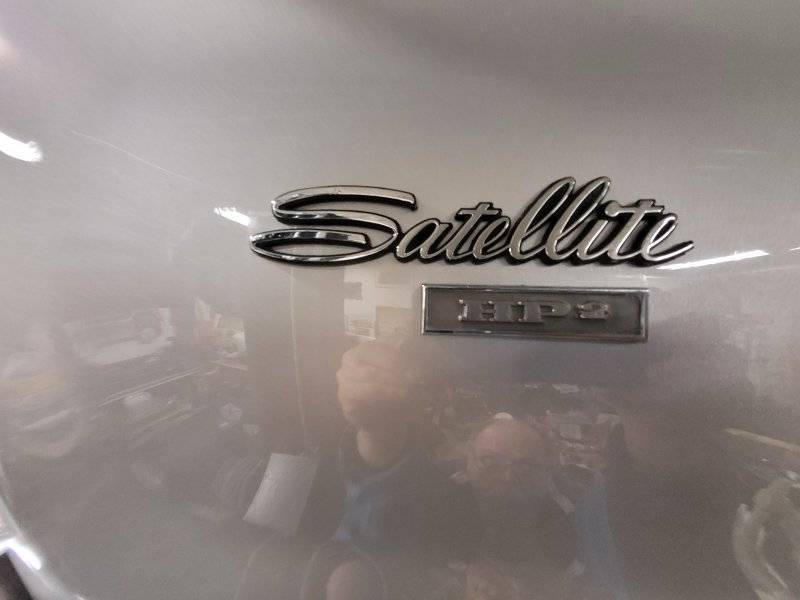

Any Hemi Belvederes built after Jan.1, 1966 would have a 426 HEMI sign located behind the wheel well of the front fender. Cars built before Dec. 31, 1965 were HP2 cars, and these signs were mounted in the location you mention.
Another thread where a picture would tell a thousand words.
Early, one of 53 Plymouths...
Yours being a March build should be 426 Hemi behind the tire as Dave pointed out.
