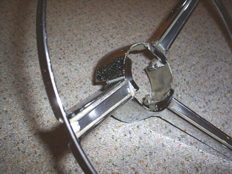

This is a picture of an old horn ring I'd saved. Once you get the center off, you will see it all.
