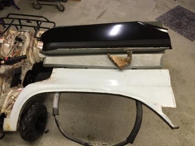

I purchased a pair of them and never used them they are way too thin like a beer can I pieced mine together the wheel lip area from auto body specialties and the section from the rear tire to the bumper from AMD the abs ones are just ok and the AMD is great but at least you are working with metal the same thickness unfortunately no one makes them
This has been gone over hundreds of times but best bet if you want your quarters to have somewhat a factory shape is to cut wheel lip from 4 door donor and use AMD Rear lower section together.
