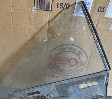

I just ordered and received a pair of quarter glass seals from Classic Industries....but I dont see how these would fit. Not sure if I have the correct seals or whats exactly going on here.....has anyone ordered these or can give some clues on what I should be looking for? 1967 Plymouth GTX convertible.
Are they really the same for hardtop and convertible and A and B body? That seems like alot of applications:
The strip that goes on the quarter window here:
This is what I have here based on the link above:
Ok....I think I answered my own question here. This seal does actually fit in the channel, however you need to remove the rubber cap on the end to get it to slide in place. I dont see any other way to do this.
The way the seal is cut there is a straight cut on the one end and an angled cut on the other. Have to assume the straight goes to the top of the window/channel.
