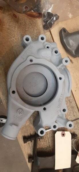

I also plan on using the 2780987 water pump housing which I believe the date cast is 10/02/67.

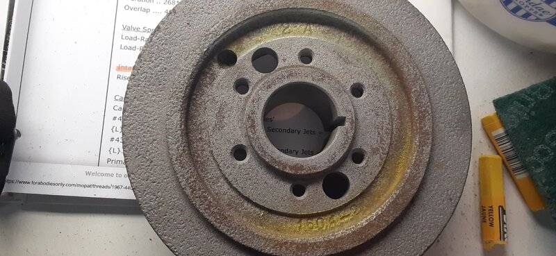

Also balancer cast #1604-2 which also has a 2A stamped on it.
Any issues with these parts? I don't need everything to be totally numbers/castings matching but the closer the better.

I could be wrong, but think the HP motors got them in '68 & later. I'd still use one even if not original.
