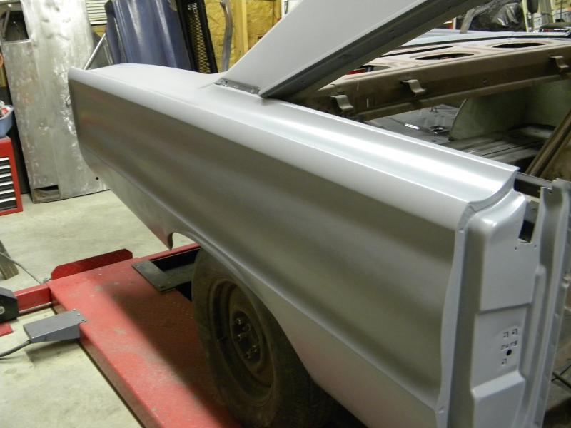

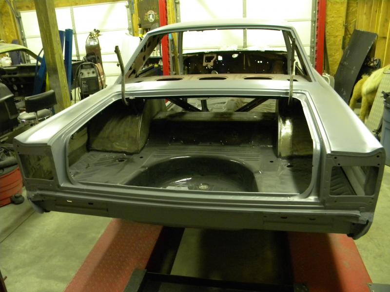

On my GTX the quarters,wheelhouses and trunk extensions were toast so we used half quarters from jc whitney which are a lot of fun to install and we tubbed the wheelhouses and installed AMD floors,cowl and inner fenders 003.jpgTinker 005.jpg
On my GTX the quarters,wheelhouses and trunk extensions were toast so we used half quarters from jc whitney which are a lot of fun to install and we tubbed the wheelhouses and installed AMD floors,cowl and inner fenders View attachment 112385View attachment 112386
I like the tubs, may be the way to go. How well did the AMD stuff fit? Thanks!
