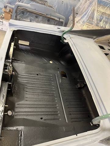

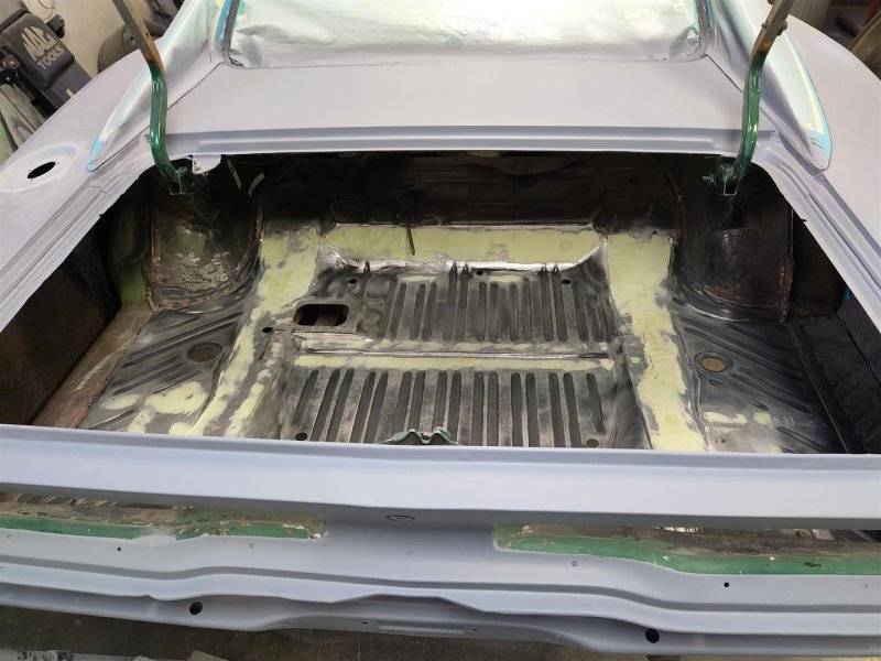

Agreed with the rest, looks like a solid project. I'm working on a '70 Charger. My body man fabricated a simple, straight repair patch for the trunk floor extension on the driver's side. It obviously doesn't look original, but it works for Grendel...she's a driver.

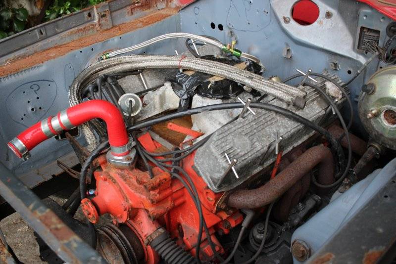

440 with a 727 transmission and an 8 3/4 based on the imagery I've seen online. Orange paint on the block implying its a later model motor thats likely been swapped in? Only have the VIN, no fender tag to work off of.
Maybe it was originally Burgundy before being resprayed to red?

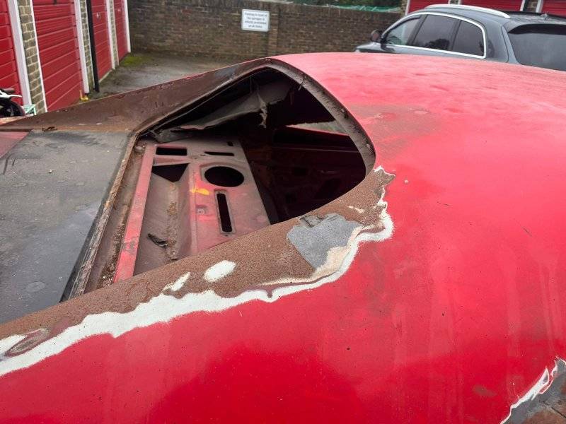

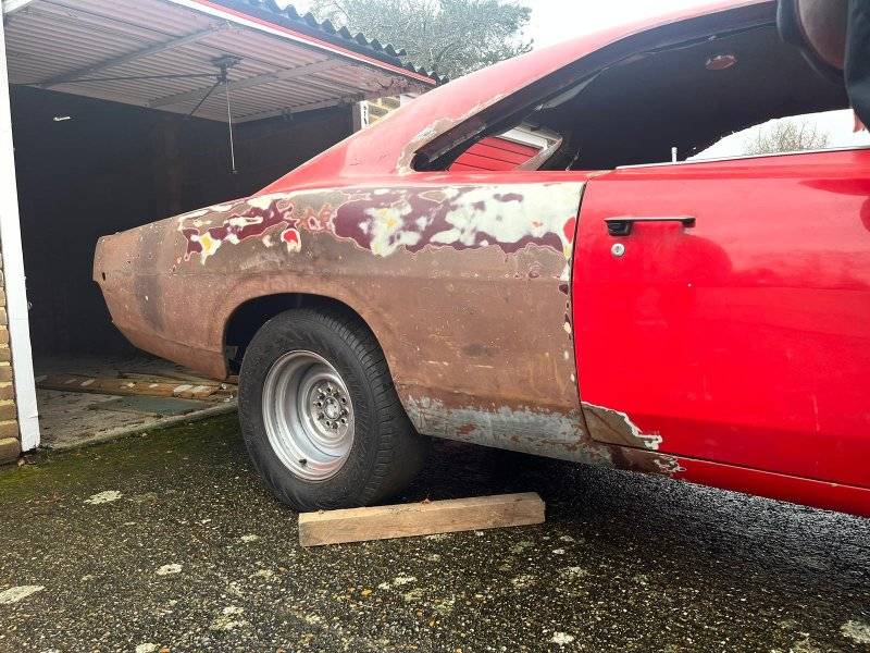

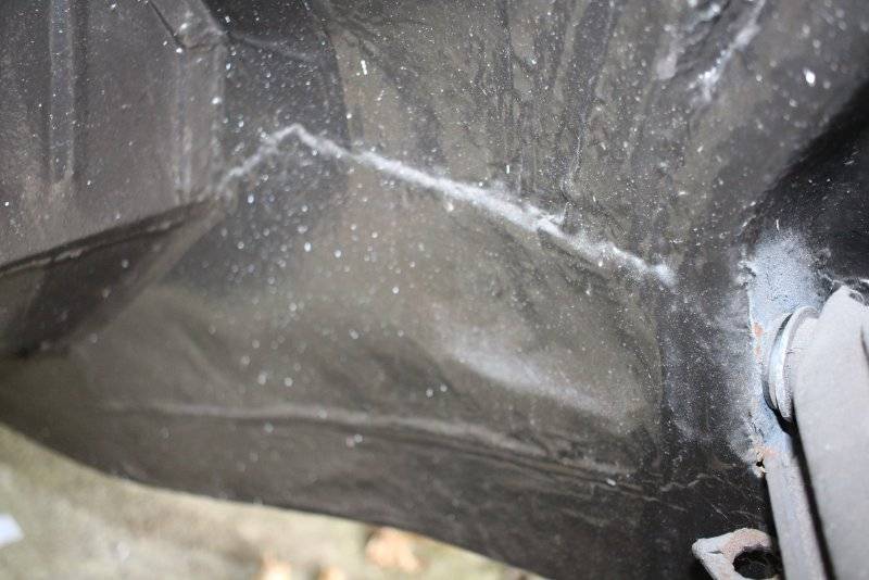

You can also see the outline of the patching that was done around the arches and the front and rear sections of the quarter panel.

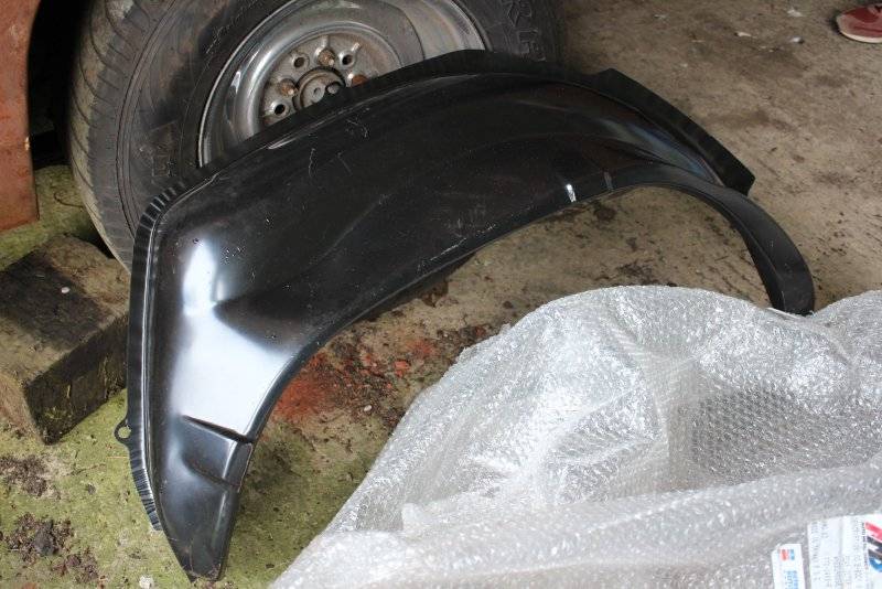

Looks like the trunk extensions and the outer fender wells have been patched (true for both sides) Not very impressed with the execution so we're probably going to need to take the quarters off and do this properly.
I did find a pair of AMD outer wheel houses in the trunk though so maybe that was always someone's plan.
I can still see what I believe is the lead filler - shame they approached the quarter panels the way that they did.
You can also see they replaced the panel on the back of the rear window before the trunk.

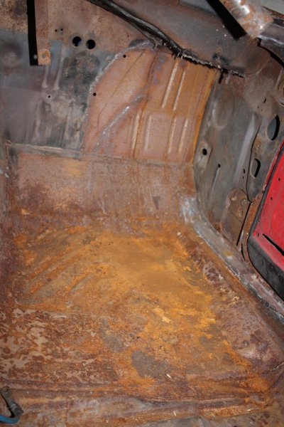

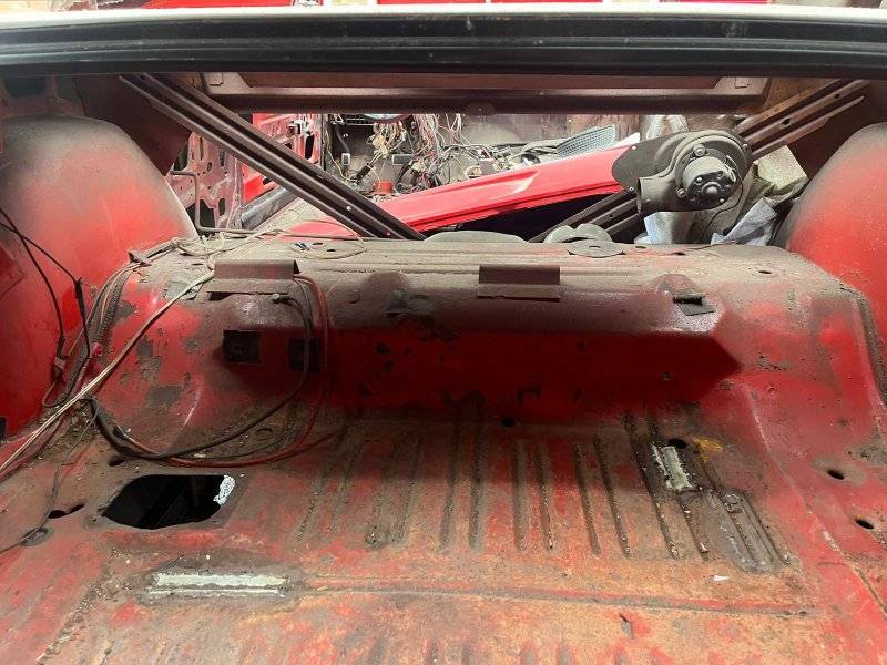

The trunk floor looks okay with some patches having been done but since the car has been undersealed its hard to really tell whats hiding under there.
It was also hard to see what was hiding underneath all the junk on the floor of the car..

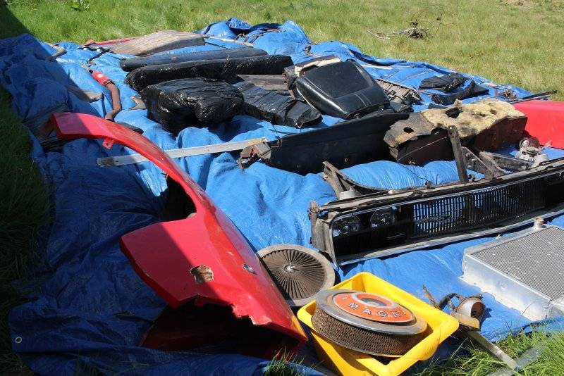

The good news is that as I went through the parts - its pretty complete as far as I could tell, maybe I can do a review of what I found in a following post before I get to the challenges at hand.
Thanks for taking the time to read up so far, I think im limited to 10 photos per post so I'll leave it here for now.

Right now, I’m thinking of picking up the following from AMD:
  • Pair of rear quarters (which also gives me a chance to replace the patchy outer wheel wells using the AMD set that came with the car, and replace the trunk extensions)
  • Pair of new front inner fenders, with upper and lower cowl to fender brackets

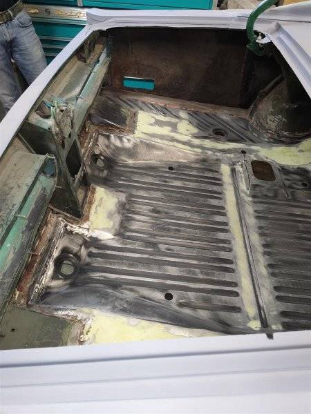

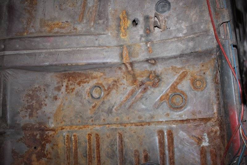

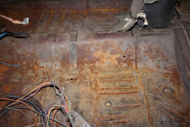

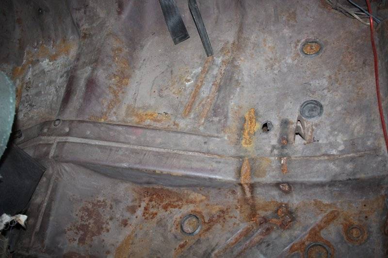

I finally got the car into the workshop, and the first thing I did was clear the interior of parts and debris — which gave me a better look at what had been done… or should I say, attempted. Most of it appears to be surface rust, and overall it’s solid for the most part.

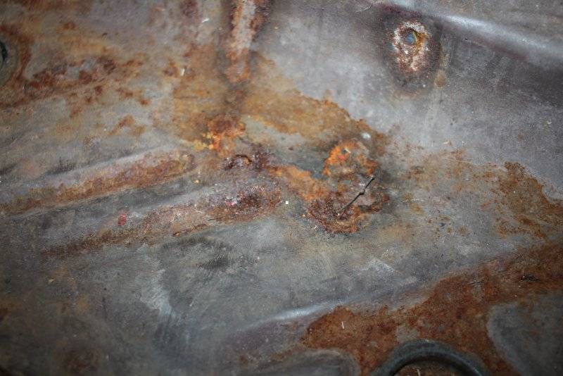

There are holes around the area where the floor support and at times the frame rail has been welded to the floor pan.
I’m not sure what to make of it or how best to proceed. A whole new floor sounds excessive, but a simple patch might not cut the mustard.
Looking toward the firewall, if a new floor pan extends to include the patch panel they’ve added around the door, I might just opt for that.

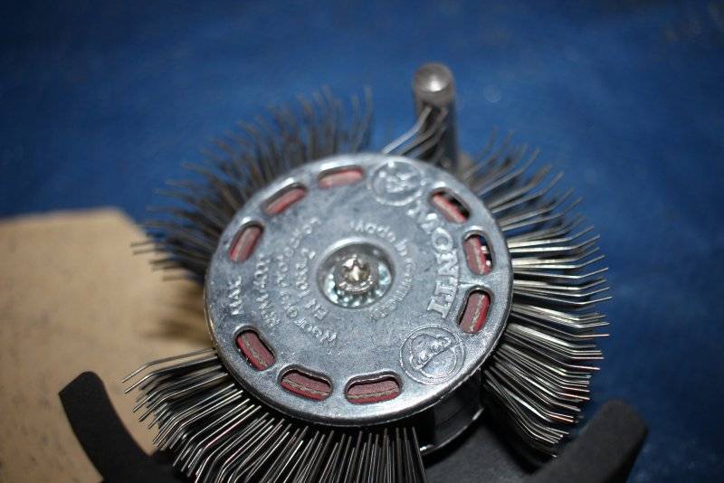

But I do like to think we had a small victory...

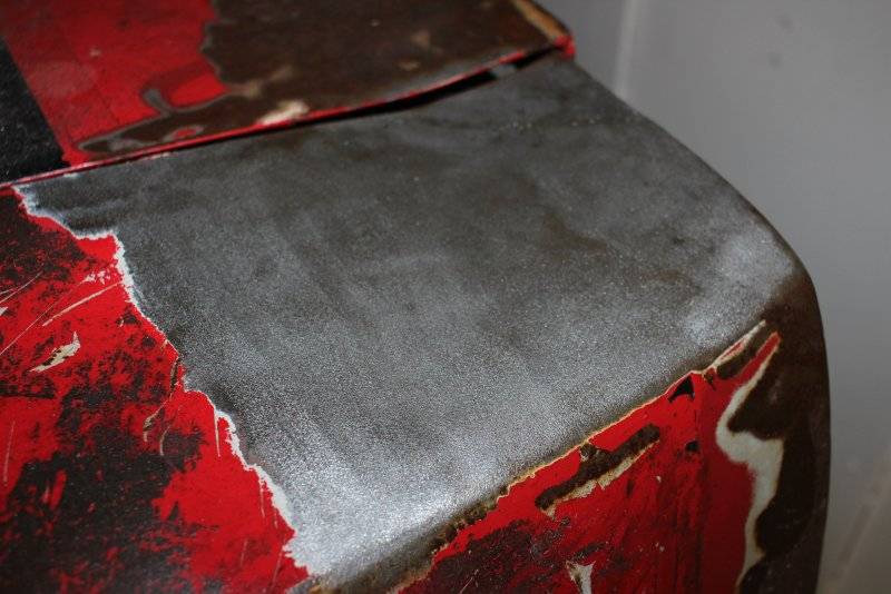

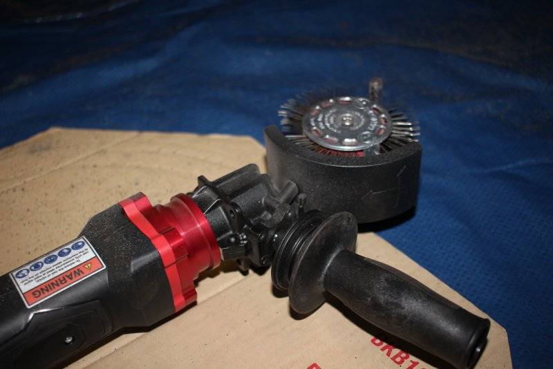

The Bristle Blaster my friend lent me is kind of amazing.
I was skeptical about how well it would work, but these bristles are something else.

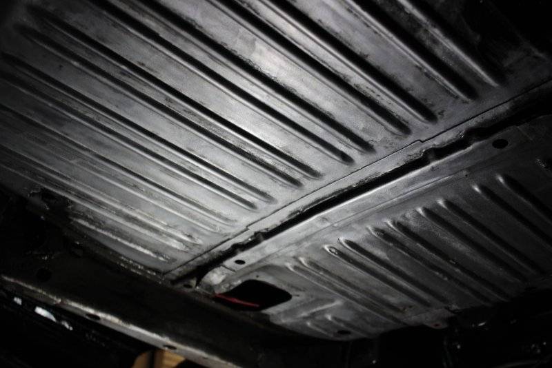

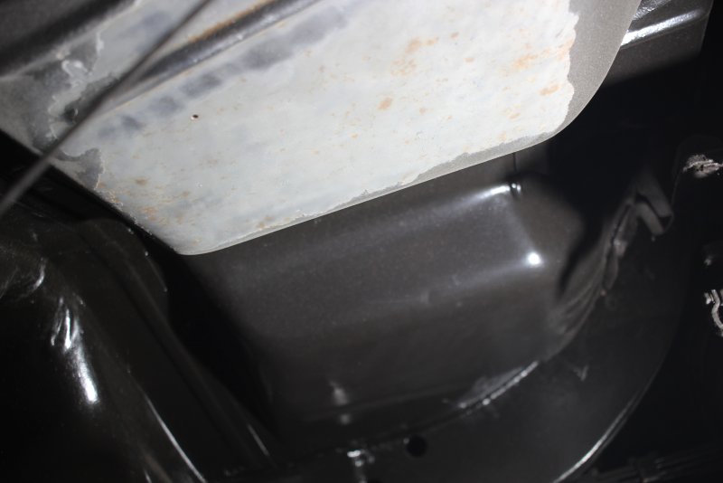

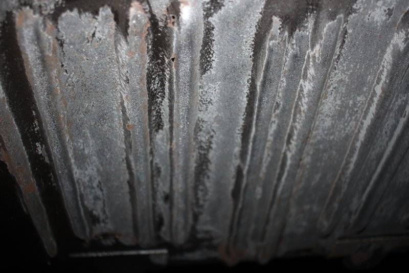

I decided to try it out on the trunk floor pan to see if it would need replacing — safe to say, we’re in good shape.
It leaves a nice, sandblasted texture, but I’ll probably need to get into some of the crevices with a wire brush.

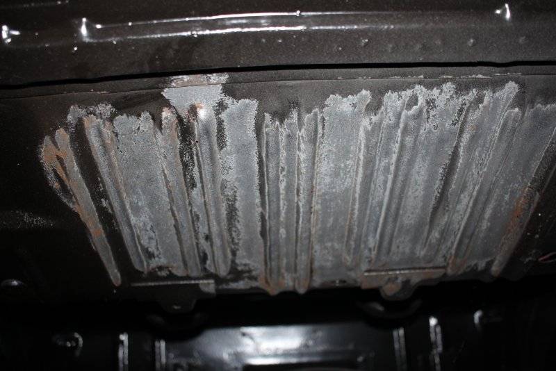

I also worked on a section of the frame rail (no photo) and I’m glad I did, because there was surface corrosion hiding under the underseal. It’s still solid, but it will need to be cleaned out.
I was thinking about blowing compressed air through one of the access holes and putting a shop vac on another. Open to other suggestions.

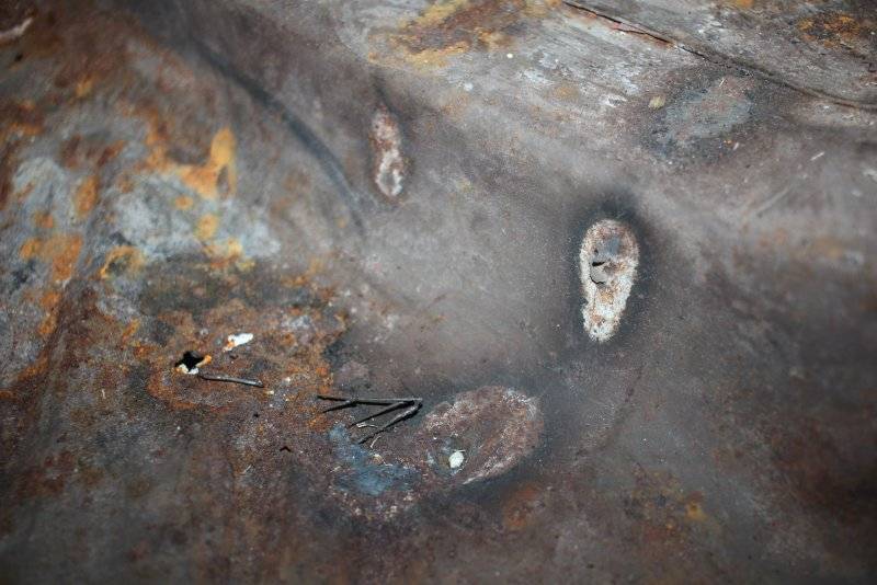

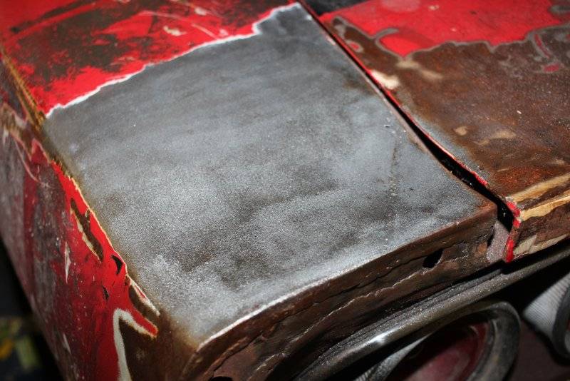

Just for fun, I tackled a rusty patch on the rear quarter. Unfortunately, it has some pinholes, so I’ll probably patch it using a section from the AMD quarter I plan to order.
Unless there’s a better approach I could take?

How much heat is it generating?
I would skip the Gibbs and shoot it with a coat of epoxy primer once it's bare and cleaned. Then do your metal work, sand, prep and more epoxy as needed.
Nothing against Gibbs - it's a great product... just not to as inserted into the body work process.
Looks like a good starting point.
Not a scientific answer but not much - I dont think its risking metal warping but I'll keep it to the underside for now as opposed to the exterior sheetmetal.

Continuing to strip it back - mostly good metal.

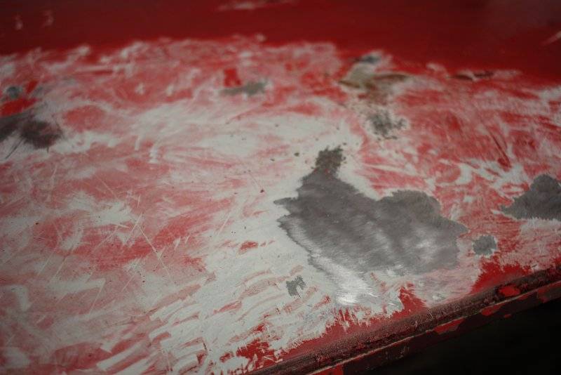

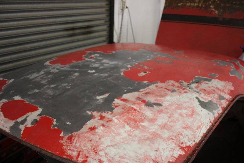

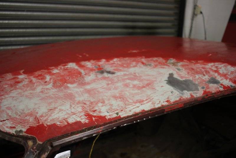

Got some Paint stripper on the roof but wow I think I need some stronger stuff - I'll revisit it with more scoring and some plastic wrap.
Also hit what I assume was epoxy primer. There were several little patches where rust was coming through so I guess it was good to take this all back.
Tested a strip disc and got down to the bare metal.

@Rook Since I didn't paint very much, I went to HF after looking over a very good but well used paint gun that I bought at a pawn shop to see how it was made. Once at HF and pulling one gun apart (junk imo), I pulled everything on the shelf and found all the parts that were machined very well and assembled my own paint guns. One was a touch up gun and the other was a regular size for painting a car gun. Even the employees that walked by didn't say a single word lol It surprised me how good they were after doing that :)
Thanks for the advice. This is my first resto, so I’m learning as I go. I’ve been taking it back to bare metal, but my concern with 2K epoxy rattle cans is the short shelf life and waste if I only do small areas. Would it be more practical to invest in a spray gun, even though I’ve never used one?
Yes rattle-can primer is substandard. You want to use 2-part epoxy primer on bare steel, and then a 2-part 2k on that. Wax and grease remover before every shoot. Sand coats for adhesion as directed by the primer.
HVLP guns good enough to shoot primers are very cheap. Get a larger tip size suitable for thick primer. They are easy to use. Of course you need a compressor too that will support the gun.
You'll have a hard time getting paint to adhere later if you oil the metal. You're best off to invest in a cheap spray gun now and put real automotive materials on. Any spray can stuff should be stripped off before shooting expensive automotive materials over them. Great looking project BTW, it has a lot going for it.

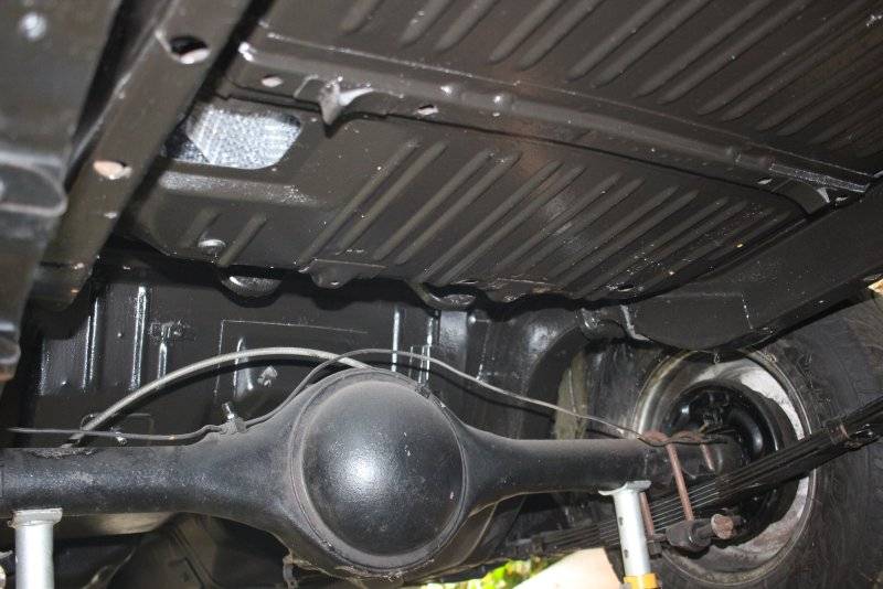

Chipped away at the underseal and the section below the rear seat pans are mint.
I've noticed light rust residue when I strip back the underseal, same under the epoxy on the roof. Was this a sign that the previous body work wasn't done well?
Need to get some serious paint stripper..

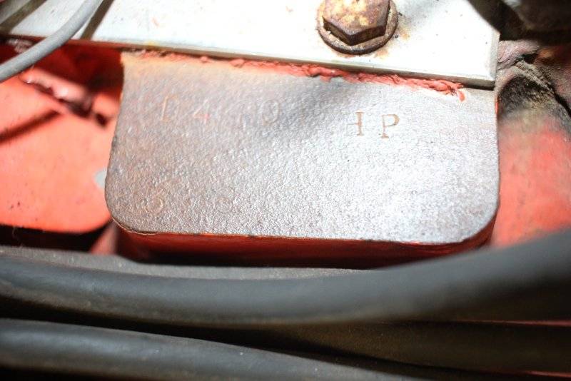

Does "Premium" mean anything on the VIN?
Also checked the 8 3/4 and the wheels both spin in the same direction so I assume theres a suregrip in there.
Motor VIN also showed 440 "HP" for what its worth.
