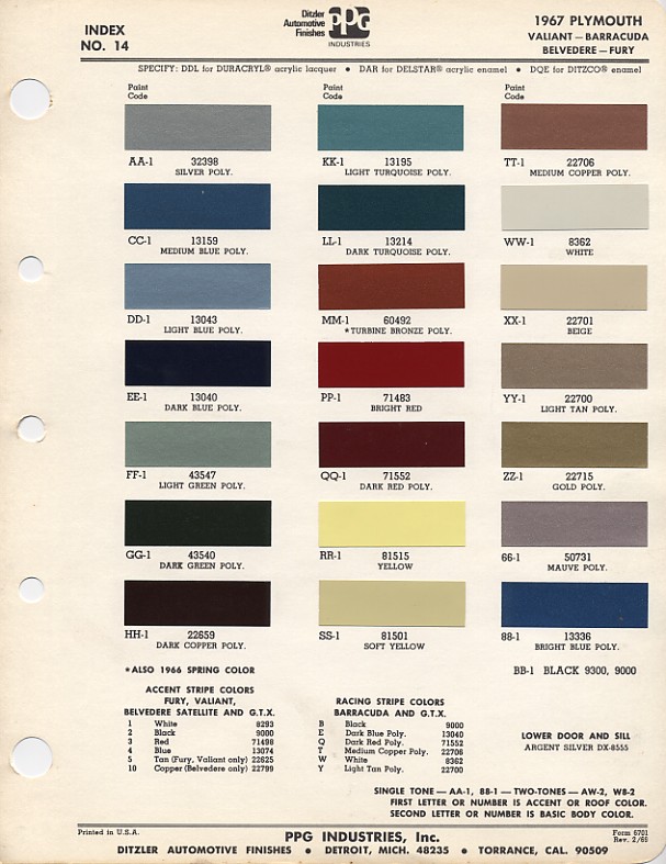

I can't find anything on 12k.. Steering code should start with "S"....HH-1 is Dark copper Poly....#22569...TT-1 Medium Copper Poly #22706
