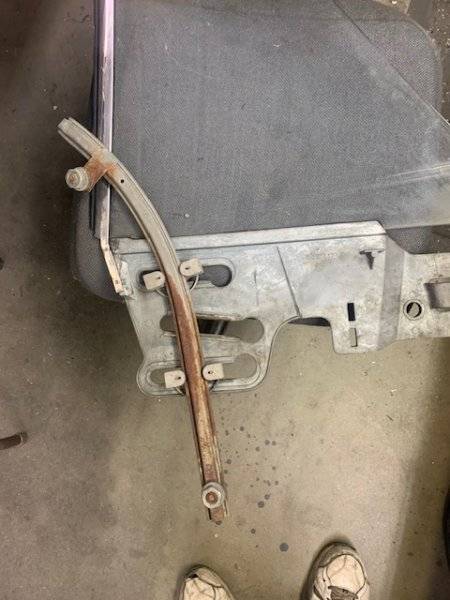

I am trying to work with the pieces I have here for a 1967 Plymouth convertible rear quarter glass. This is for the Tommy Boy restoration and when I got the car the glass was just laying inside with most of the pieces missing. I was able to get what I show below, but think I am still missing a window track if I look at the photos and documentation I have. Can anyone confirm that for me?
This is what I have:

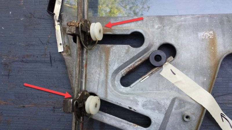

I assume that the angle brackets that I am pointing to here attach to a front window track thats missing....can anyone confirm that? Makes sense that there needs to be a front and rear window track here.
You seem to have a good handle on what's missing... You have the glass, do you have the rollers? That curved track is vert only. hard top uses a track but it's different... The rollers are also different for a vert
Ok, so I am missing that curved track then. Im hoping someone has a photo they can post of exactly what these missing pieces look like.... or better yet an extra set. Obviously I need that to get the glass in place.

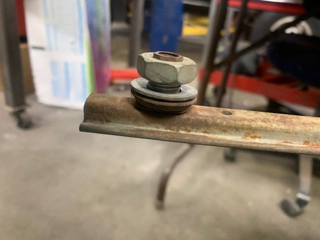

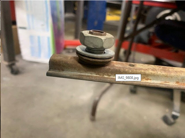

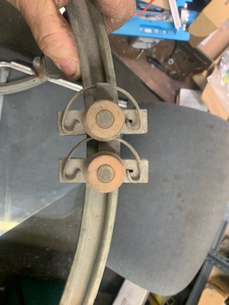

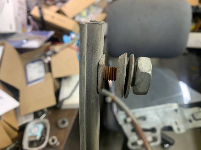

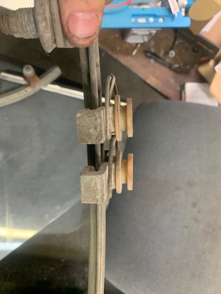

I have mine out of the car, I'll try to get a few photos tomorrow
Ok...that would be great.....
Is it possible that these window tracks are the same on 66 to 70 B Body convertibles?
1 Wild R/T...can you post photos of what you have? You mentioned you have them out right now. In particular the hardware that holds these in place. I assume there is an adjustment on these so I need to try and get the hardware with it at the same time.
Last night I set an alarm on my phone to remind me to get photos... I was working at my shop today went it went off... And for the life of me I couldn't remember why I'd set it up... I thought it was because I was supposed to give a buddy a hand but he's cancelled... Sorry, I set it again & tomorrow I should be able to get it done...
Ok sounds good.....that will work. I know without alarms and post its all over the place I would never remember what I am doing from one day to the next.
Ok thanks for those photos thats great. Much appreciated.
The adjustment hardware looks exactly the same as I see on the rear quarter window track that I already have here? The rear track has one, and from your photos this front track has two. So if I find a track I need to make sure I have the adjustment hardware with it looks like.
The roller assemblies I dont have at all. Not sure if they sell those or I need to look for that now used as well? Hopefully these are the same 66 to 70 as well?
The adjusters are common, they fit B & C bodies
The rollers look like hardtop ones but they are different, the part number is 66-70 b body vert only I was helping a guy with a 70 Roadrunner vert that had hardtop rollers & the glass wouldn't line up..

Contact Murray Park at cbodies.com. I got a pair of the rollers for my 68 GTX convertible from him. Paid $50 for two. He will know exactly what you need and is great to deal with. C bodies used the same ones on certain models.

Just a clarification for anyone still looking at this post, the track in the first photo is installed upside down. The curved end should be at the bottom.
