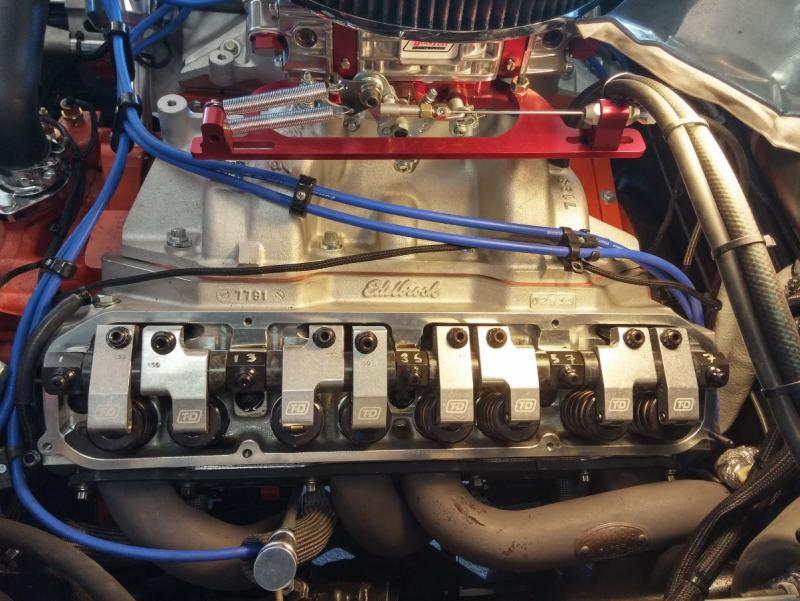

Before I installed the Micky Thompson valve covers I took a pic of those sweet T&D rockers.

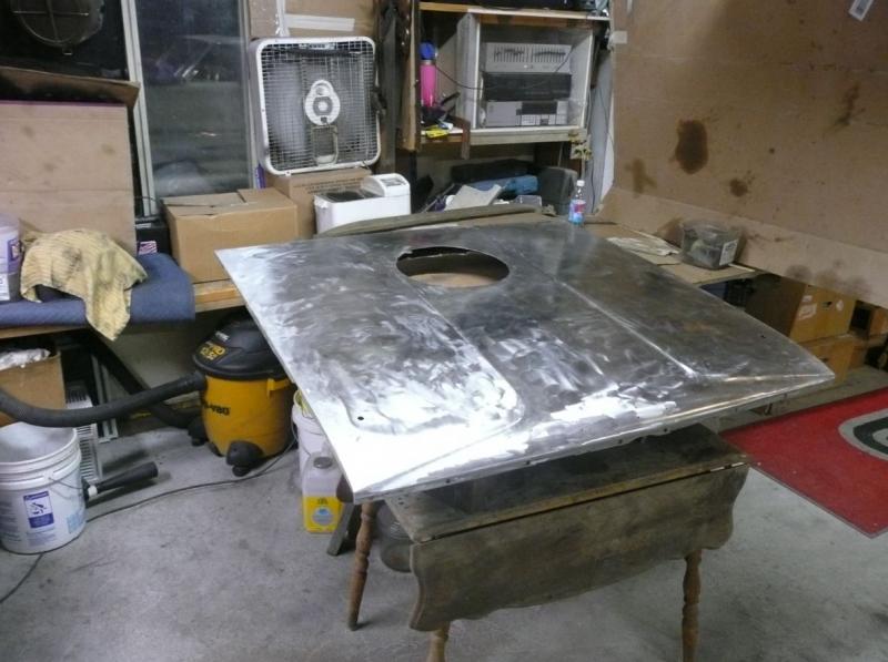

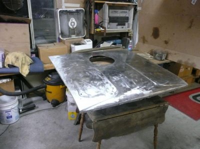

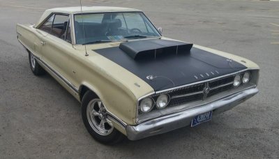

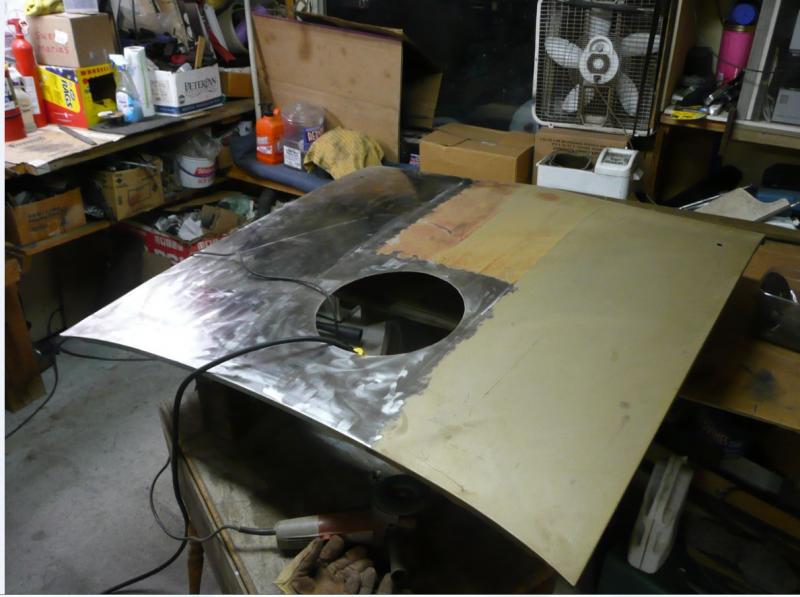

Got the top of the hood stripped. Going to paint it and the scoop flat black.

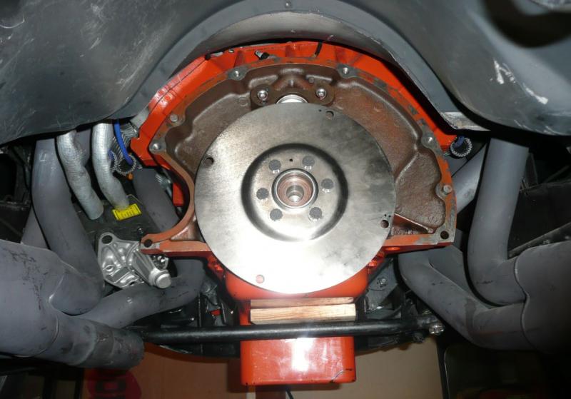

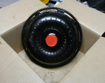

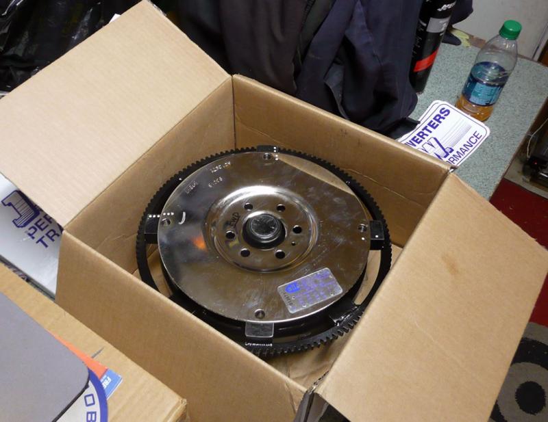

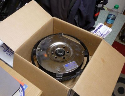

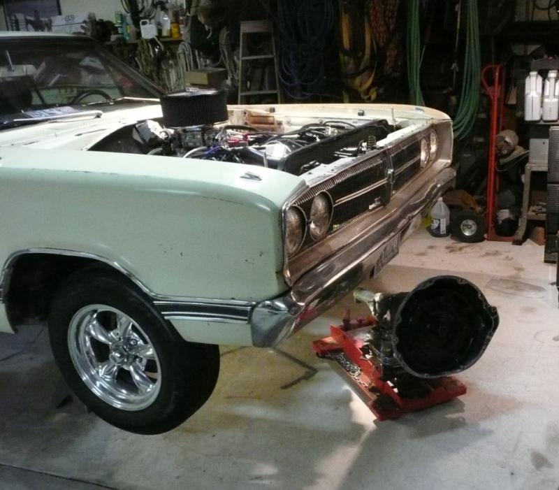

Installed a JW Performance 3400 stall torque converter and flex plate.

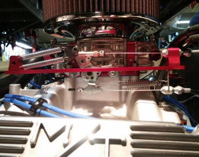

Installed a Lokar kickdown on my TF727

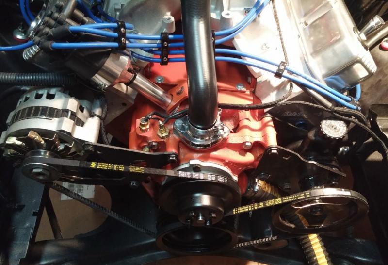

Put in a new Saginaw power steering pump.

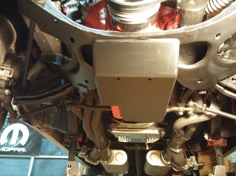

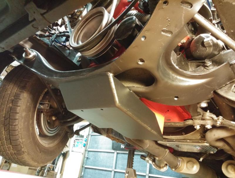

Installed a oil pan skid plate because I am paranoid about hitting something with my low hanging oil pan.

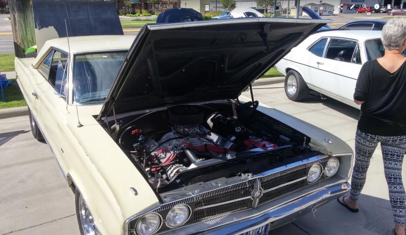

Finally got my hood installed and brakes fixed, car is really running great.

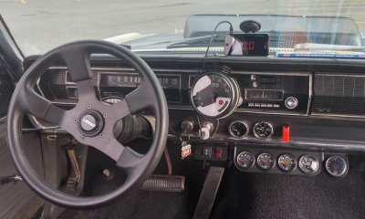

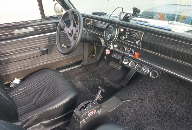

Here are my gauges:
Top: Speedo GPS Phone, VDO Tack
Middle: Fuel Level, Fuel Pressure, Fuel On/Off
Bottom: Cutouts Open/Close, Radiator Fans Override ON, Voltage, Oil Pressure, Water Temp, Tranny Temp, Air/Fuel Ratio
Awesome, looks great MT! Something about those big scoops on a Mopar that looks right (very intimidating). I like the skip plate, should set your mind at ease a bit.
Wow, very similar story here, solid GA car with a 440 transplant COOL. You are 2 years ahead of me. My 67 500 is getting a hemi hood scoop very soon, you really nailed it.

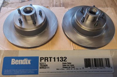

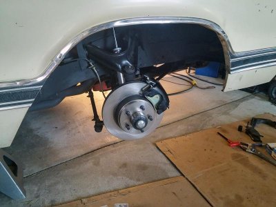

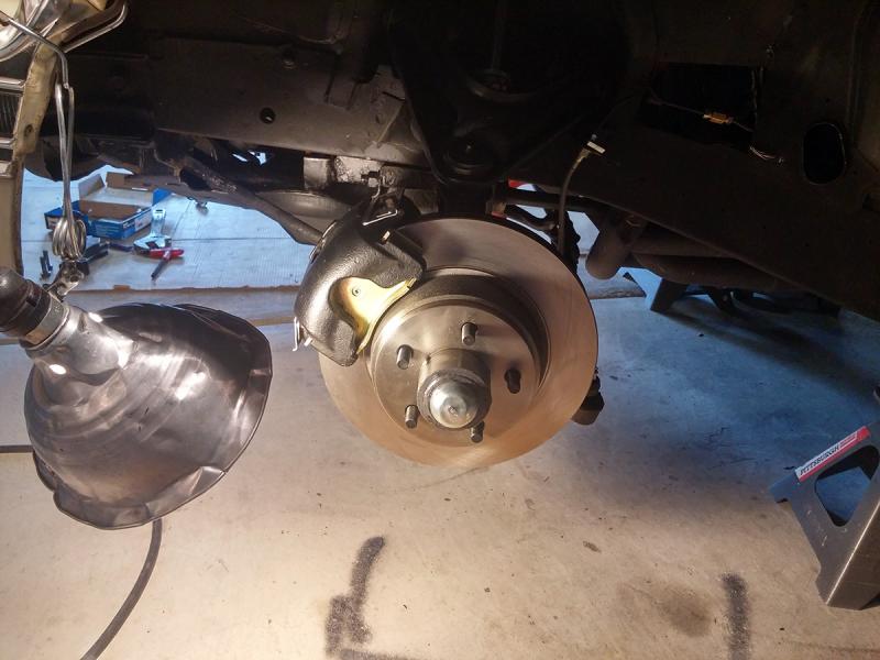

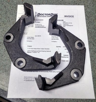

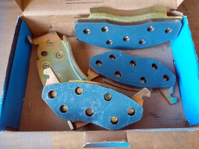

I upgraded my discs to the larger 11-3/4" rotors and added new Bendix Titanium Pads.
This upgrade is simple, economical, and only requires replacement caliper brackets and rotors: (requires inner seals), you can even use your old pads if you want.
Caliper Brackets: Dr. Diff $90
Bendix 11 3/4" Rotors: Summit $37.97ea
Rotor Inner Seal: $1.97
Bendix Titanium Pads: $36.97
Check out the video from the RamMan below at: 4:00
This is a serious brake improvement upgrade. I bedded the pads in on first drive and it is a huge improvement in stopping my car.
I am really liking this setup.

Thanks for the info John. Looks like a decent, quick upgrade. May just do this myself!
BTW........Congratulations to your clamp on shop light for surviving whatever war, Armageddon, and second coming it's obviously gone through :headbang:
You bet Will, the RamMan... he really is the "man", what a great bit of information for an awesome upgrade! Took me just a couple of hours and it was all put back together, didn't have to even crack the bleeders. Awesome!

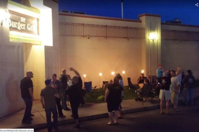

Having fun with the Muscle Car Club this weekend, nice to see quite a few Mopars in the mix too.
We rock with Tiki Torches on Friday's and Saturdays

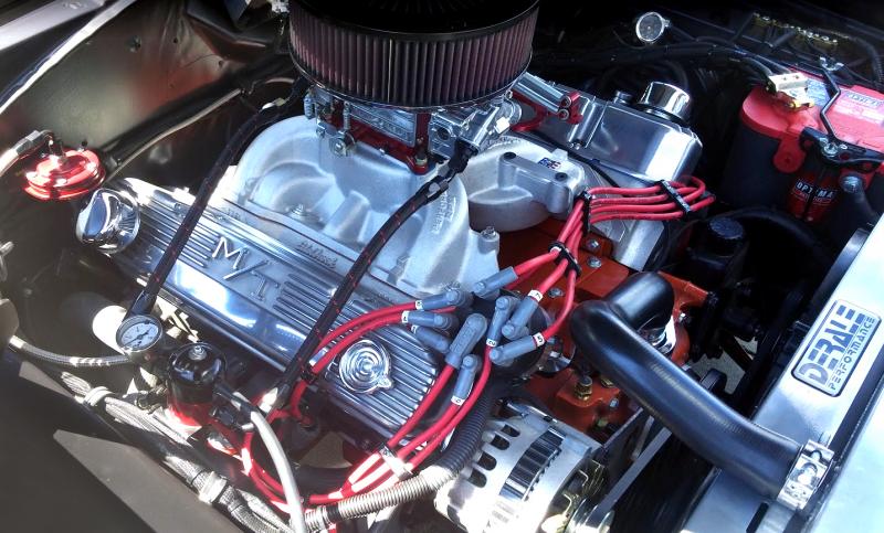

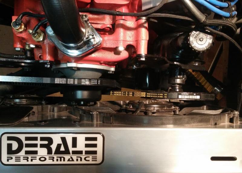

Changed up my 6AN fuel lines. I found these from Vibrant Performance, they have the lines in Black/Blue also. I like the look of the red, crap... now I am thinking I need to put the black MP valve covers back on.

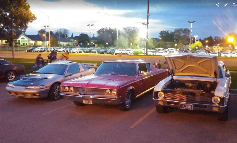

Here is a pic from our hangout last night, my buddies blown challenger putting down 700+hp
