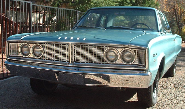

I don't think they will fit period. They will certainly rub when turning. I have
2-15-70 or 78s on mine.
here is a pictures of it.
