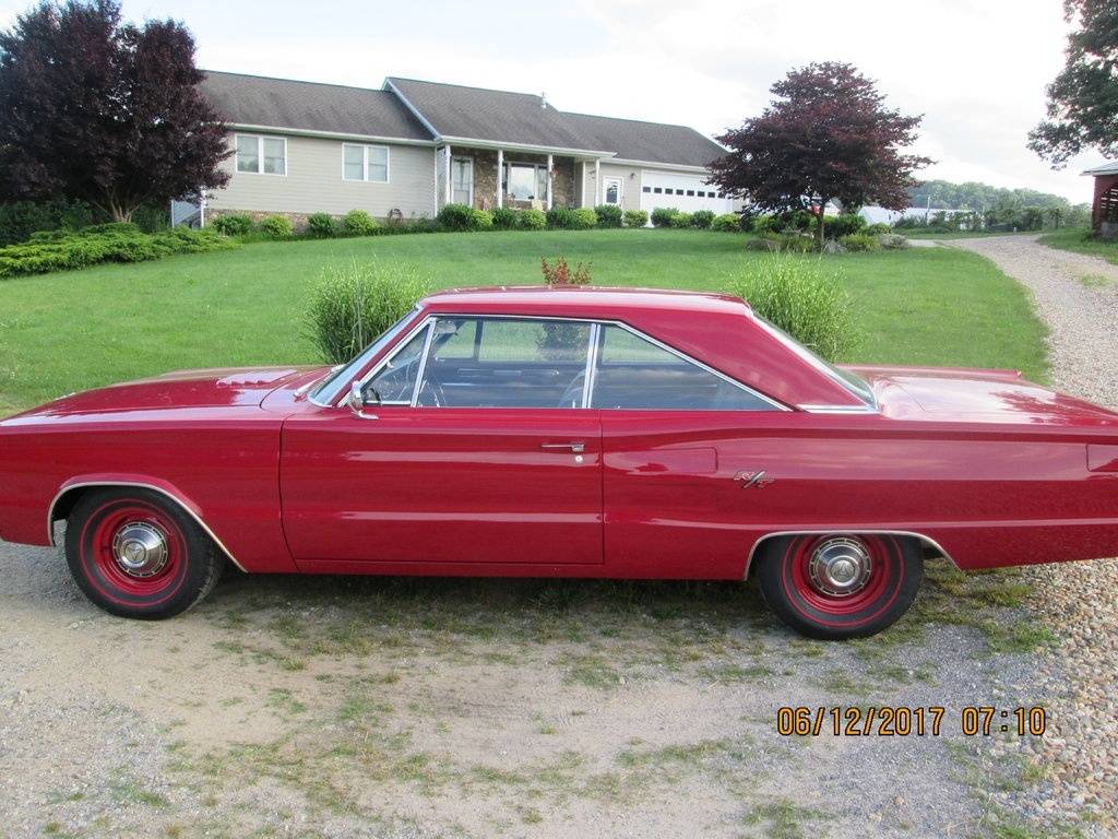

Thanks for the input everyone, I have the ride height at the top of the front tires and the back tires is about 3/4" below top of the rim from the wheel well trim. For some reason it just don't look right. I think by the responses that it is pretty close to where it should be. I am used to my friends 68 rr that had some rake to it. Any suggestions by looking at the picture or leave it where it is. Thanks, jts

Nice looking ride! Personally I would go with a larger rear tire, but thats the style I like, do what makes you happy!
I think it looks great. Again, it's all about what YOU want to see when you look at it. Personally I agree with Mike67, I would increase the height of the rear tire a bit to get the body angle higher from back to front, even if only by a inch or two.

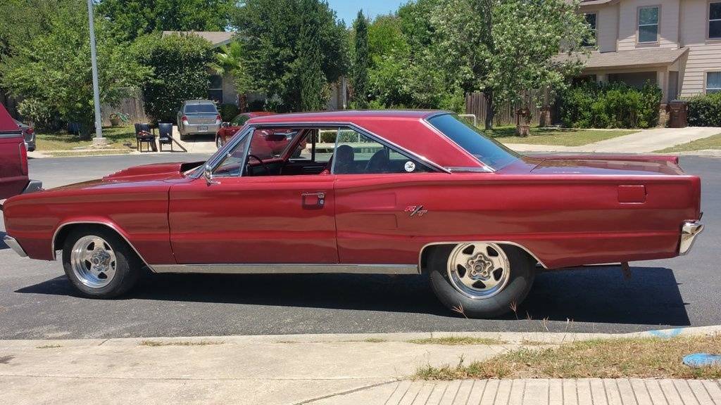

My 67 RT sits quite level. A little lift in the rear would be nice. I find the rear fender well makes it look like it's sitting heavy on the rear.
Exactly. That's the thing with these cars, the rear well is lower in the body line than the front and makes the car look like it's sagging in back.
I personally like to see about an inch of the tire visible between the rim and the top of the wheel opening. That's the ideal look for me.

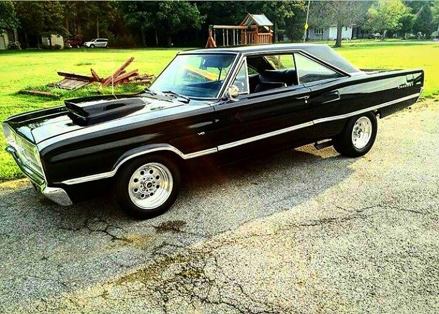

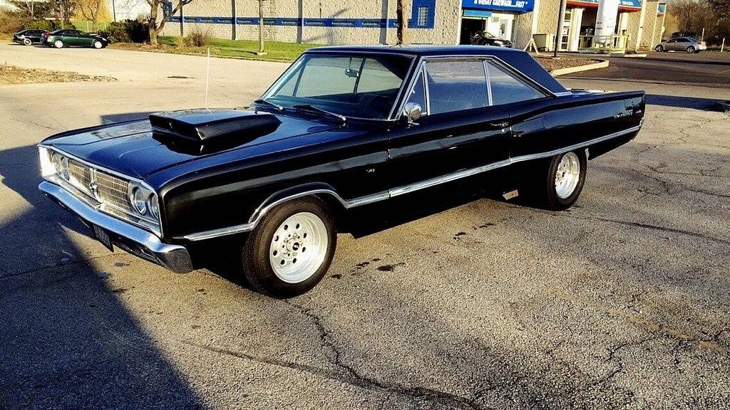

My bodyline over the tire looks similar to yours but I have a taller tire so it has some rake to it.
