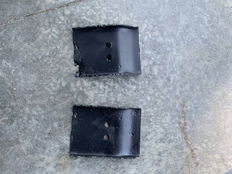

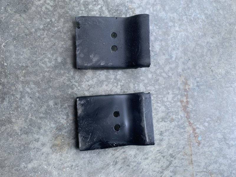

Are these brackets for the front bumper? If so, how are they installed? Thanks!

Hi Charger Too,
Those are the rear bumper corner supports.
Cheers, Tom

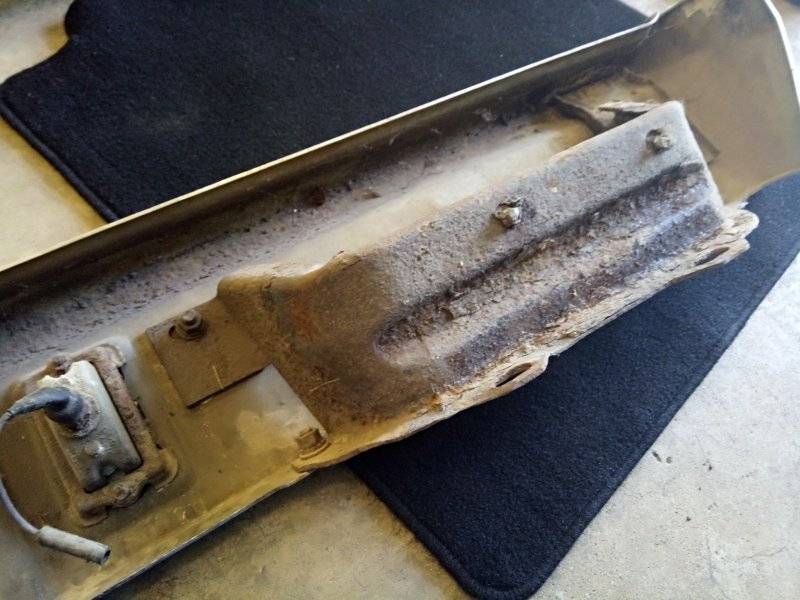

I like the finish on the brackets, I have mine off to clean up before I put my re-chromed bumper back on the car. You just gave me the look I want. Thanks

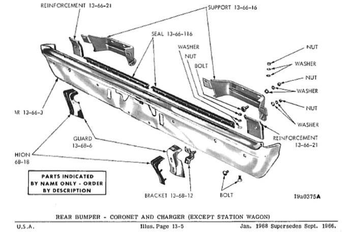

My 1967 Coronet never came with those. Charger only?
Hi Dave6T4,
Reinforcement pieces originally should have been on there (Charger and Coronet), maybe omitted during a repair at sometime? Sorry for the catalog page quality.
Cheers! Tom

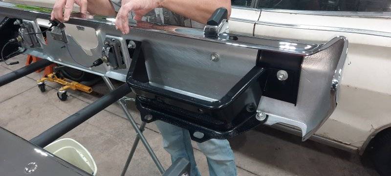

Thanks Dean,
The brackets are powder coated, careful to match original finish. Since my car will be a driver, I used RPM on the hardware as well.
