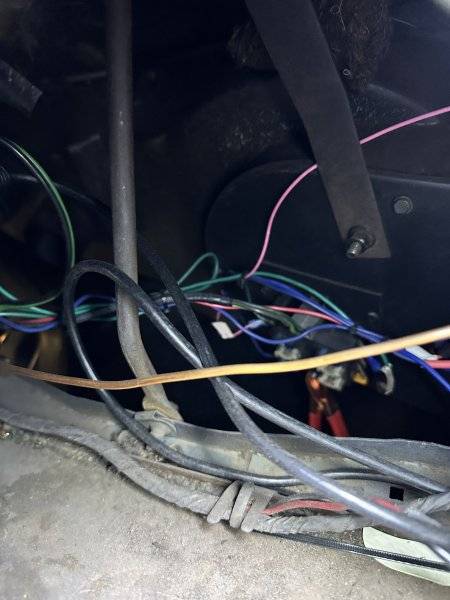

Looking for help where the supports mount inside dash any help appriciated
I have a 67 plymouth belvedere, and the only support rod that i know of for the dash is the one that is near the right side of the radio, and there is a stud where a nut is used to secure the dash to the cowl. Dunno if that helps.
You have the pedal assemby in black, the radio support in red, then the general support in green
These are all I have, dash is now together, do you need one of where pedal assembly bolts up?
that's the only one I know of... the rest bolts to the dash frame and body via the MC mounting bolts and the MC plate from what I remember.
that is the passenger side, bolt is circled in red... drivers side mounts to support from dash frame
Thanks a lot I’ll have to figure out where the second support goes by the glove compartment which is bent 90 degrees on one end help was bmvery good your friend steve
