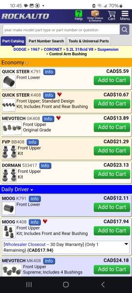

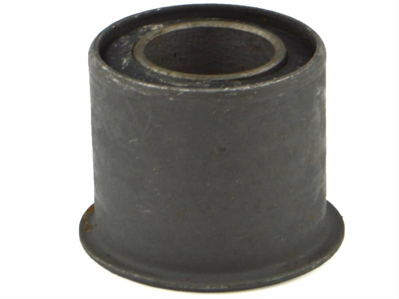

Good afternoon,
I am looking for a replacement part lower control arm bushing for my 1967 Dodge Coronet 440. See below for the 'starred' image. Any help is appreciated.
It's not an easy job. After the arm is pulled you have to get the old one out and then press the new one in. The last 2 I did I just burned the rubber out then air Chesil the bushing in half.

Proforged are supposed to be better than moog if you want rubber. Other option is poly lower control arm bushings. Never used them before but other say they have a harsher ride and sometimes squeak.

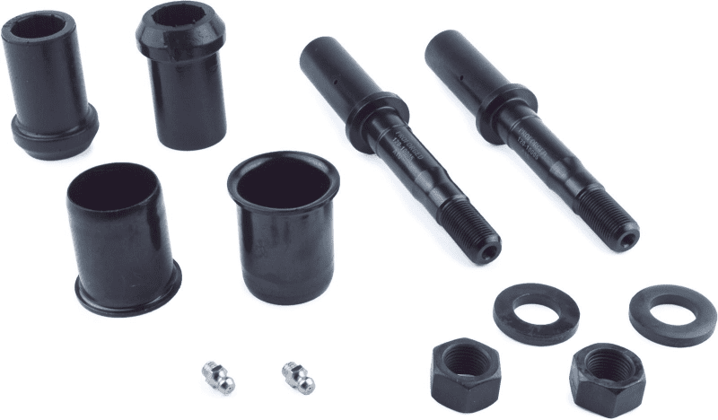

View attachment 1930059Get this setup form summit racing.
Proforged Control Arm Shaft Kits 120-10005. I just did it last week on my 67 Charger. The hardest part was removing the pin from the control arm. I used a small drill bit and drilled around the old bushing until the pin was somewhat free. Then just keep spinning and pulling the pin until it comes out. The bushing is easy to get out once the pin is removed. Just make sure you don't damage that shell the bushing sits in, that's where your poly bushing is going. The kit will come with new shells, but you won't need them. Make sure you order the silicone grease; energy suspension sells it. Best $124 I spent.​
