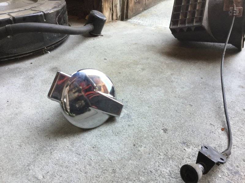

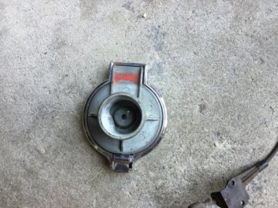

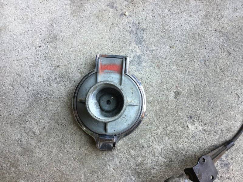

Mine looks galvanized also. Is this the cap you're after?
